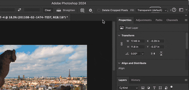

Two tips:
1. If the minimum value is too large, like 0.6, then automatic snapping may be enabled. You can override this as you drag by also holding down the Control key (not the Command key), which you see me do in the demo below when the ^ symbol appears. As long as you hold down the Control key, you override snap, and can rotate in 0.1 degree increments. This snap override applies to rotating, moving, and other transformations. (If you never want Snap on, choose View > Snap to deselect it.)
2. Regardless of whether Snap is enabled, the further away you drag from the rotation center, the more precise it is, because you have more rotation “leverage” (each degree of rotation has more pixel precision when the arc is larger). You see me do this in the later part of the demo below, where I am dragging close to the edge of the screen.
