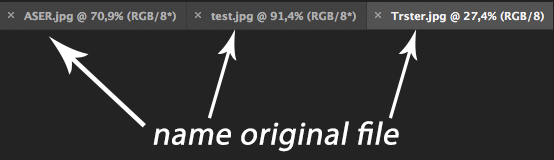

It happens to me that the name of the document changes
these are the original names
after the script this happens
change the original name to (file_ ")
This is not good for me
I wish the original name would remain.

The problem is this before using the script the names are these
After I use the script it happens that it changes the name to so

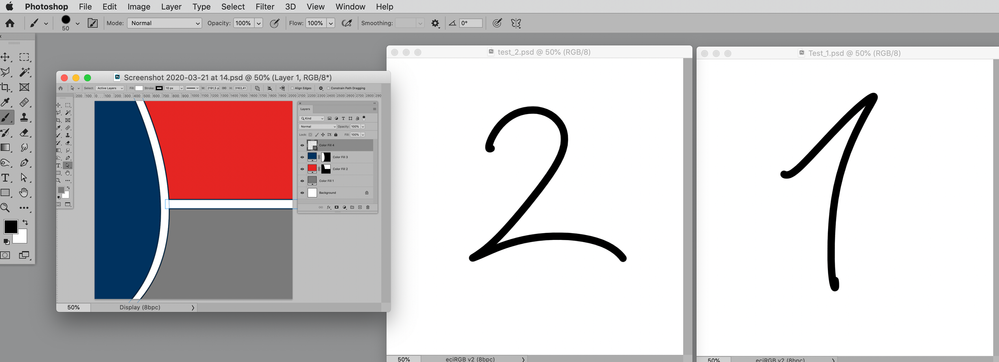

I tested the code from DmitryEgorov’s last post and from this
I get this
There should’t be an open jpg after running the Script, so just to make sure: Did you run the last version?

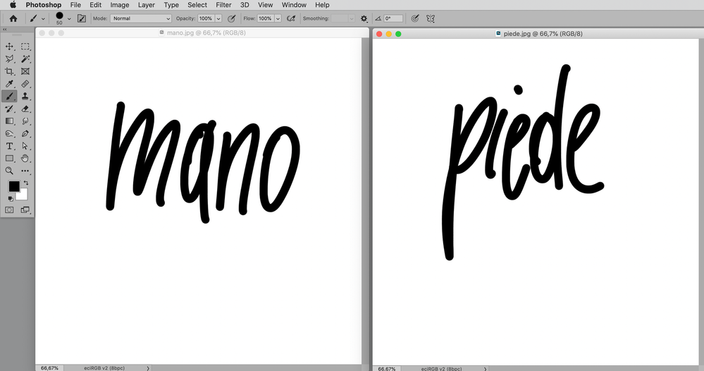

In the previous post I already showed what happend for 3 open files for me, this time for two with the names »mano.jpg« and »piede.jpg«:

The names seem to be honored, see screenshots from before and after running the Script:

Seems I can’t post screenshots on this Forum at current, but I tried with the names »mano.jpg« and »piede.jpg« and it worked as expected.
