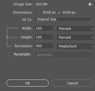

I rezised original by 24% and PPI went from 400 to 1666. Image quality is way superior to resizing with resample checked.
With this information, how do I know what to do thereafter?
Which sceneario would make me opt to resample instead?

You know where the grey pixels come from now, resampling
Try this - to resize without resampling as Stephen suggested:
open - image / image size
uncheck 'resample'
set width to 'percent' and enter 24
click OK
it should look fine on the screen now if you view it at 100% / 50% etc, not an in-between number,
[click command 0 to get 100% then command + or - to shift between view values. ]
but what is the resulting PPI number - you may end up with a strange resolution

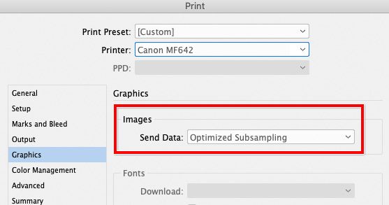

This brings us to the answer to your other question: When would you want to resample? The answer is whenever the originals are much too large for the workflow. Images take memory to process and store. If your project involves a large number of images that each have far more pixels than needed, then they’re needing more RAM to process and more storage/backup space than they should. It might also take longer to print. For example, if you’ll be printing on a 300 dpi printer, then an effective resolution of 1666 ppi is quite high, so in that case you could downsample it by a fair amount while keeping the effective resolution above the 300 ppi that would take advantage of the full resolution of the printer.
If there is a concern that oversampled images might generate too much data for a print job, you can set InDesign to downsample placed images on the fly, in the Print dialog box. (“Pour them all in and let InDesign sort it out”)
