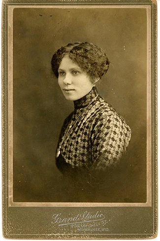

This may be more a problem associated with early photograph processing, but what I'm seeing is very peculiar.  I have a photograph (of my lovely grandmother) that was taken and processed and printed in about 1915.  Here is a scan (scanner is Epson V600 Photo) of said photo....
However, this is the way it prints (printer is Epson Artisan 50)....
The print looks like this whether I use 'Photoshop controls colors' or if I let the printer do so.
It appears there was some material added by the photographer to scrub the lower part of the subject so that the image would look as it does.  However there is no actual color in the original print, as you can see.

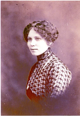

Since my last post I photographed the Old Photo and processed same to this
image.....
It prints, however, like this....
This print appears to be lacking in yellow, even though the yellow shows up
on a nozzle check. In more than mild frustration I replaced all the ink
cartridges with Epson cartridges, which I bought a couple weeks ago because
my prints looked a little strange and I thought it was due to some really
bad generic cartridges I had bought earlier. Nyet. Even with a full range
of Epson cartridges the print looks the same. (And yes, all the prints
were in jpg, which I'm assuming squashes layers.)
I also noticed the open line on the left of the subject, and supposed it
could be due to higher resolution of a slight blur. Also nyet, see below.
