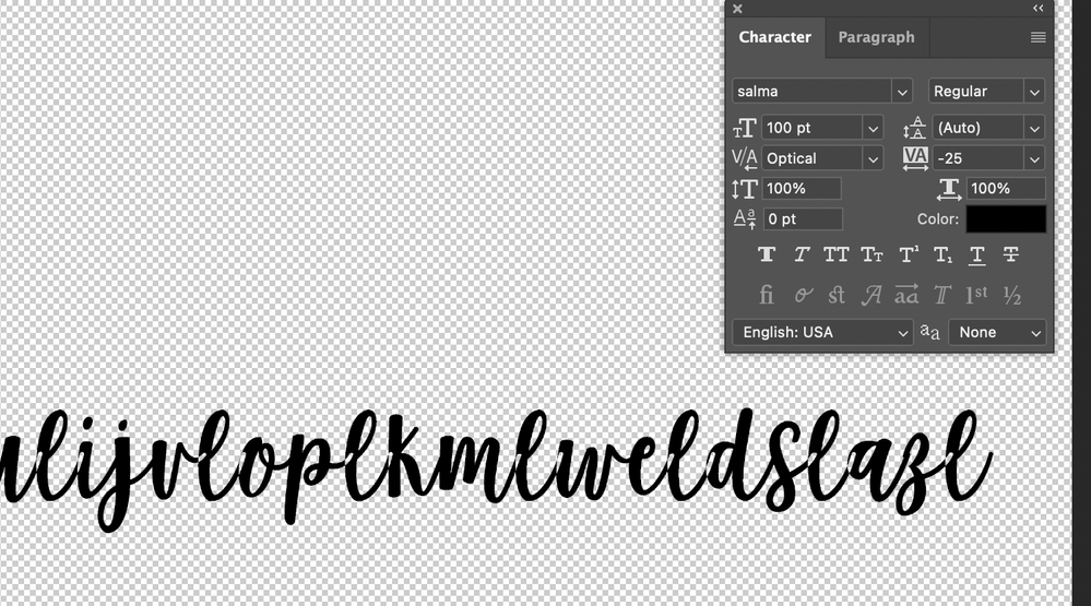

Mar 12, 2021 Mar 12, 2021
Thanks all. Tried kerning, still the same issue. Also, per the other advice below, I don't want to convert the text to paths/shapes each time because I'm using this in a template, so the words are changed for every version (for customization).
After even further investigation, it appears that this only seems to be happening with the letter "l" - all other letters will merge together just fine (see screenshot). I've emailed the font shop to see if there's a solution.... It's also odd because this does not happen when I use this font in any other design program - Pixlr or Photopea.

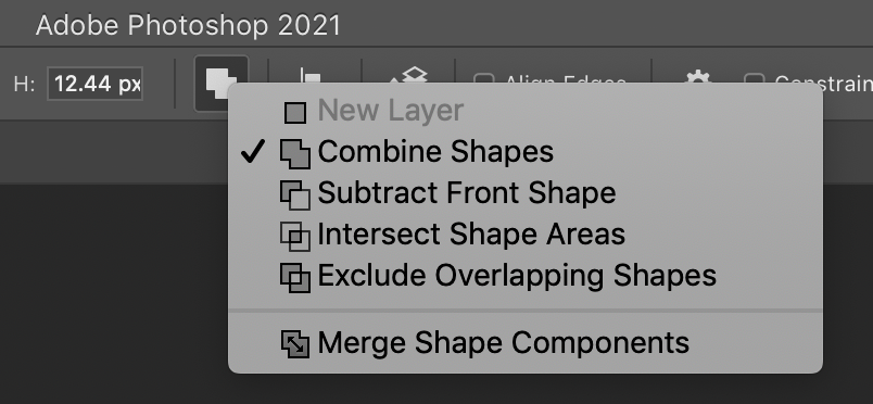

What if you try Type > Create Work Path, and use that path as a mask for a Color Fill Layer. Then try various Path Operations, and see if you can find one that won't give the white gaps. Of course, it will no longer be editable type.
Mar 11, 2021 Mar 11, 2021
Are you having the problem with live text or have you converted it into a series of vector shapes? If you have converted, there is a Path Operations menu that could explain and correct this odd result. I'm happy to explain further if this isn't detailed enough.
