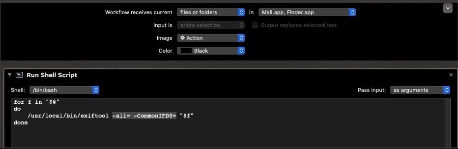

It's been about 2 years since all my Indesign files suddenly got HUGE, even if my PSDs were small. One thing I realized after reading this topic is that most of the problems came from files I got from other clients, generally on PCs (I'm on a Mac). So, as a former programmer, I imagined that the Metadata inserted on the files via PC got scrambled OR were misread by Indesign on my Mac, resulting in this massive increase in size. For example, my INDD files used to be around 5 to 10Mb... since the problem started, they went up to 80, 100, 140Mb each! And since I use Google Drive for automated sync, that became a major PAIN!
So, after investigating ExifTool with a programmer friend, we came to the following result - which is PERFECT for me:
Using Automator on my Mac, I started creating a new QUICK ACTION - which is a command that is accessible through the finder itself, right clicking on the files/folders you choose (yes, you can select several, even a folder - in which only the supported files will be processed).
Then, we came to the following configuration for the QUICK ACTION:
- First, select the "Files or Folders" in "Finder.app" (please ignore the "Mail.app", that was included by mistake hahaha)
- Next, search and add the "Run Shell Script" step.
- Now here comes the MAIN THING: you MUST change the "Pass input" to "as arguments" - that way it's possible to have all files/folders come in after the exiftool command, or else an error would happen. Observe that the only part you have to worry about is the third line in the code, where I defined the location of exiftool (I did try using without a path, but got errors also!), then "-all= -CommonIFD0=". I didn't include the "--icc_profile:all" part since I DO work with images that have color profiles applied - don't wanna lose that, right? And the INTERESTING part here is the "$f" that comes at the end - which means "put in the names of the files and folders HERE, please!". YES!
- Last but not least, not shown on the image above, I also included the parameter "-overwrite_original”, after I tested this throughly. As it was, I'd get a copy of the files I selected, always... and after doing a lot of checking, I finally decided to use the Overwrite parameter. Now I'm really happy!
So just save the file and you'll automatically have it in your right-click menu, under "services".
WHAM!
DONE!
PS.: Since you have all those bloated INDD files, remember to do THIS: after you use the exiftool on all the IMAGES placed in your INDD, do a SAVE AS in Indesign and overwrite it. That way, all the information is freshly saved, no trash AT ALL. It was beautiful to see 140Mb Indesign files come down to 5Mb. What a JOY! 😄
Thanks again Stephen! Fantastic TIP!
I hope my collaboration helps people also!

@Erik Lingerfelt
I believe that you are inadvertently removing the ICC profiles with the ExifTool code that you posted.
The following two arguments in red are quite destructive, broadly removing most common metadata. The argument in green is non-destructive, the double -- hyphen instructs ExifTool to NOT remove any ICC profile related info:
exiftool -all= -CommonIFD0= --icc_profile:all '/Users/username/Desktop/icc.psd'
Note the following Terminal.app status messages in blue:
1 image files updated
exiftool -all= -CommonIFD0= '/Users/username/Desktop/icc.psd'
Warning: ICC_Profile deleted. Image colors may be affected - '/Users/username/Desktop/icc.psd'
This is why I originally wrote:
"The following command strips most of the metadata without breaking the file..."
Which in hindsight may have been a little cryptic. I have just updated the original post to make things clearer, sorry for any confusion. ExifTool is a very deep program, the ability to use the double hyphen to "contradict" the command to remove all metadata is a good example of the flexibility of the software.
Explorer ,
Mar 28, 2022 Mar 28, 2022
Oh!! Thanks!!
I do wish to keep the ICC Profiles, yes!
Thanks for the update!
