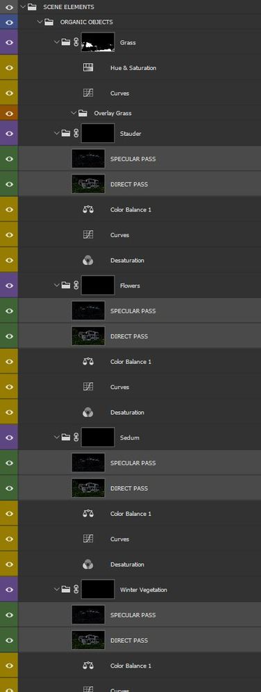

Hi!
I am making an action to create my Start file that I use on projects.
I have duplicated a group multiple times with layers, and each group has an unique mask, but similar layers. I want to select all layers with the same name that searches all layers sets.

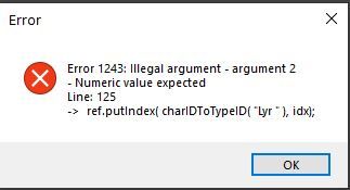

I found this script, but I get this error:
Participant ,
Jul 07, 2021 Jul 07, 2021
URL to thread I found Script: Select all layers with the same name
LEGEND ,
It's fixed. Try again.
