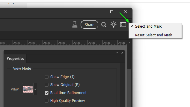

Apr 21, 2025 Apr 21, 2025
Something else worth knowing is that when some of the panels get confused, there is a reset button via the top right drop-down
