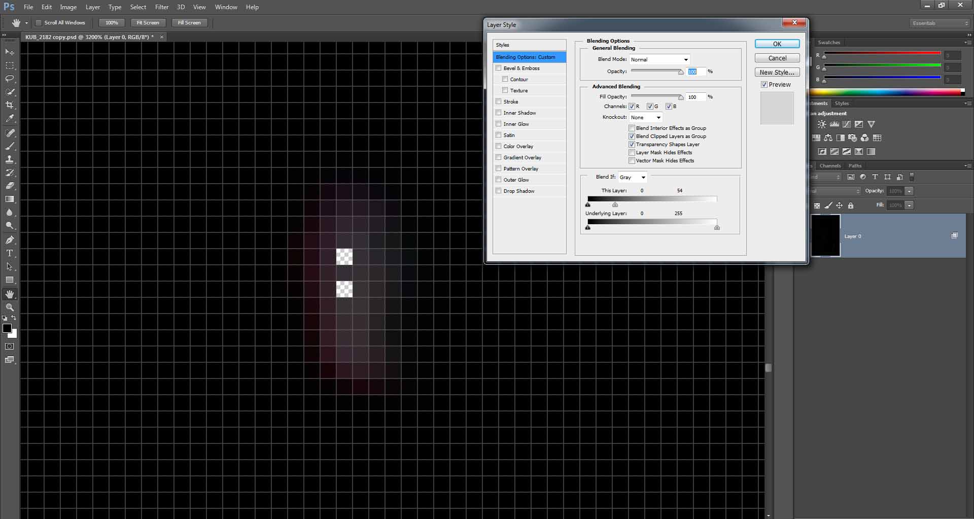

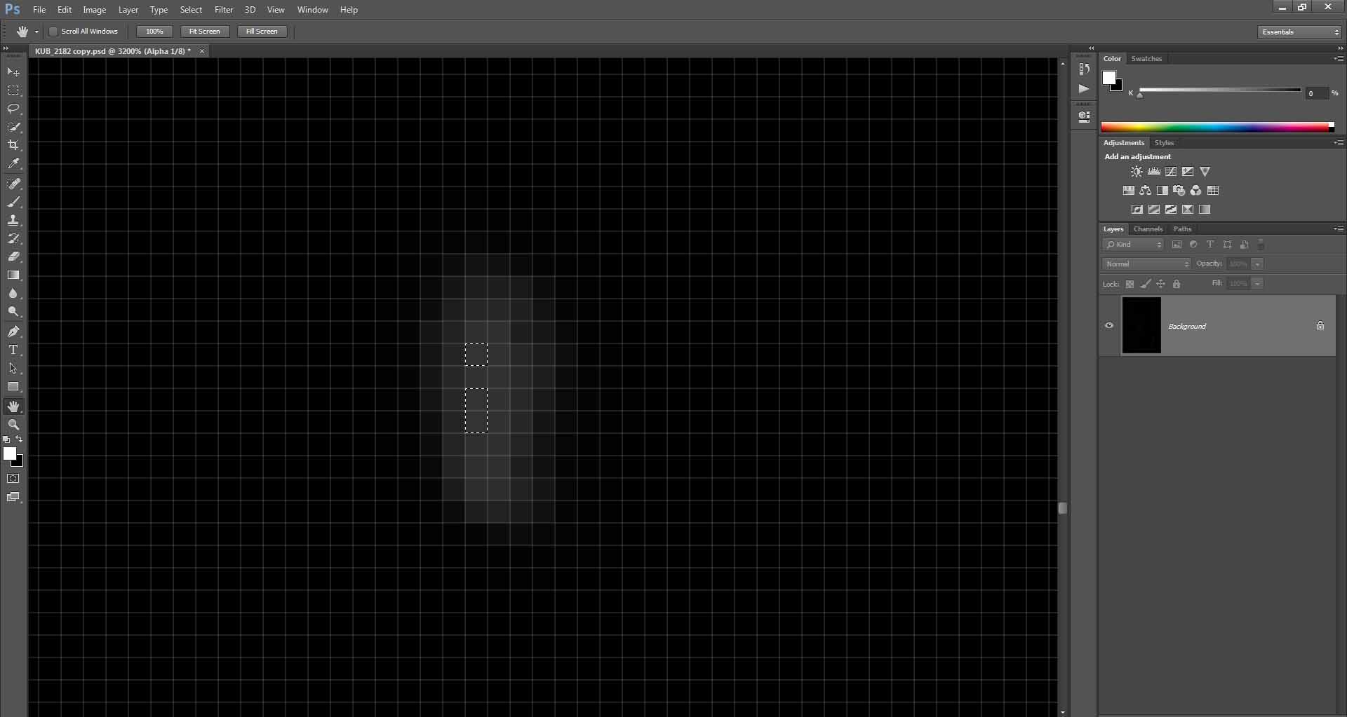

im afraid to tell you, but the script is acting weird...i tested the script and that is what i got.. in the first image we can see the pixels script selects...image 2 - we see the very first value that opens up the brightest pixels, it is - 54. image 3 - we see which pixels the following value 53 open up... and if we compare these two values with the pixels script finds we can see that there is something wrong...Seems like the script still adds extra pixels. but those pixel are not from the following value (53).. it is like between 54 and 53...

is it because of the color?
Oct 16, 2014 Oct 16, 2014
I am done with this Script as my (superficial) testing seemed to reveal no problems with 8bit images.
The operation works on the composite Channel so the individual RGB Channels may provide different results.
If you want to improve the Script go ahead.

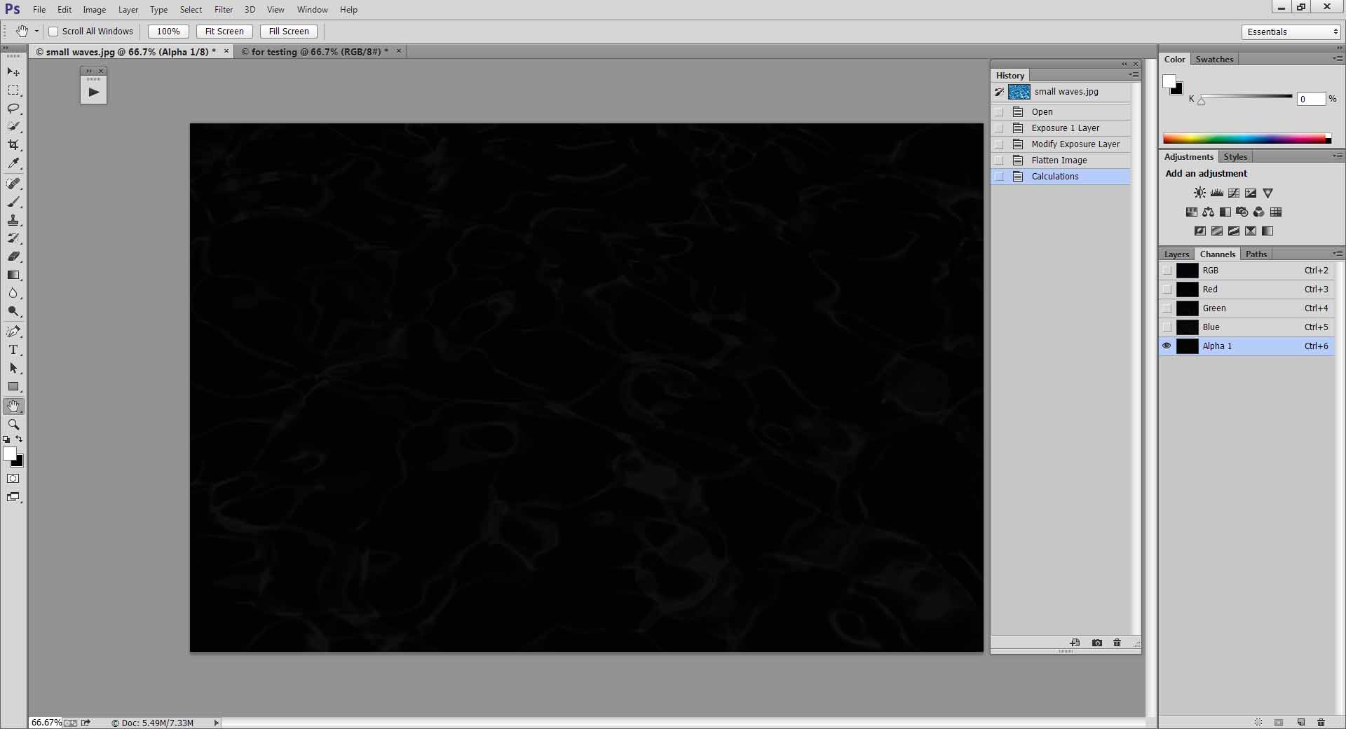

First of all, thank you very much for such an incredible work. based on my skills, i would've taken a year to write such script. I mean it. I appreciate that so much. Just one little issue i have encountered. i wonder if it is possible to fix it. If you have a little more time please see the images. I tested the script and learned that it selects more pixels than the very brightest. In other words, it includes pixels that are less as bright as the brightests..
i reduced exposure to make sure the difference is clearly visible...
Edit: we can see in the pictures that the brightest value is 14. But the script has also selected values which are lower than 14.
