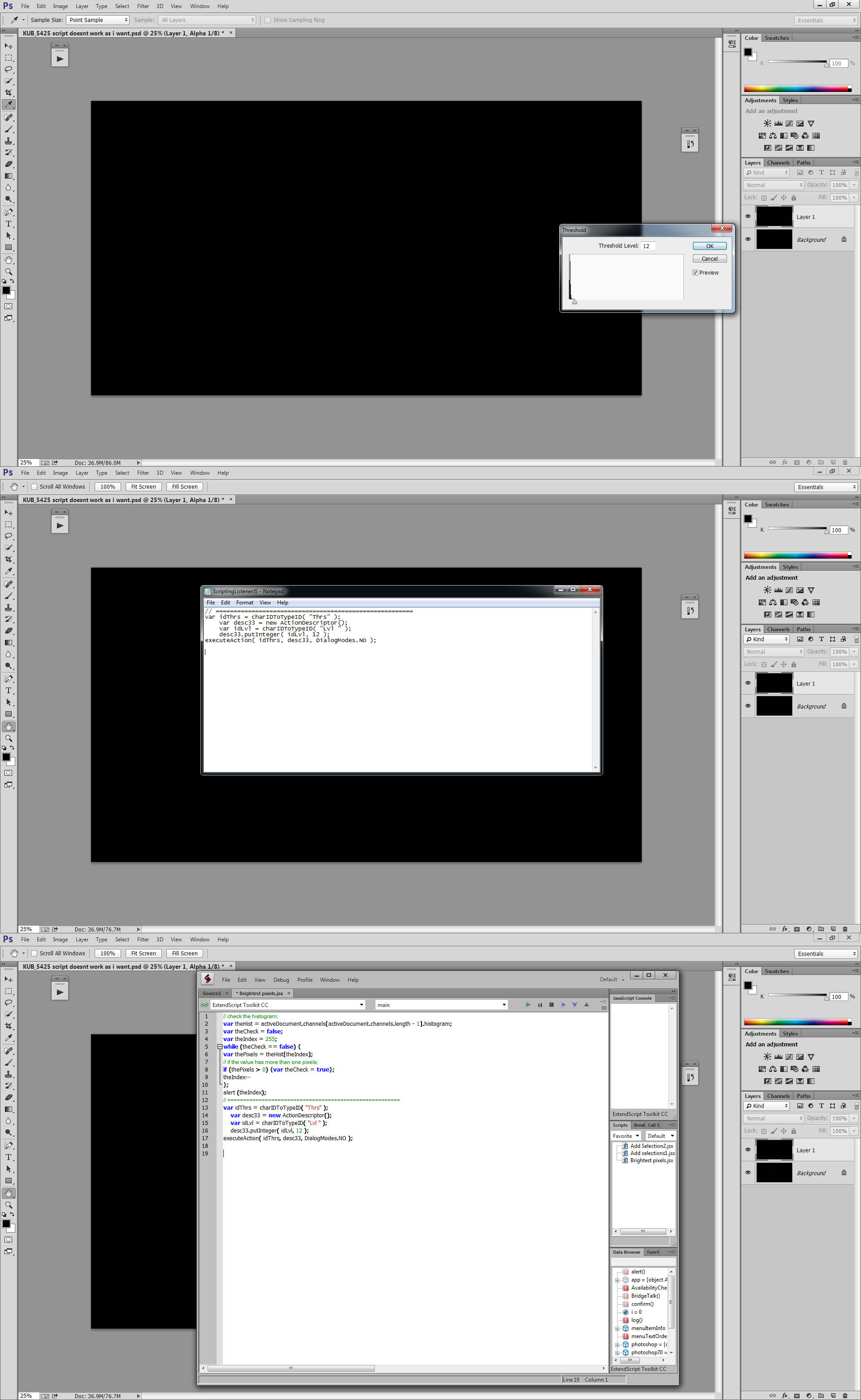

Please im still stuck.. help.. please look at the screenshots... what am i doing wrong?
Sep 15, 2014 Sep 15, 2014
You are trying to run the Script in ESTK, not Photoshop.
I omitted the line
#target photoshop
because the code was only a fragment that you need to combine with the other steps anyway (the Selection, Quick Mask Mode, …).

Please tell me what i'm doing wrong... this time i've faced two problems.. one: the script doesnt place marching ants after i run the script? what did i do wrong? (please have a look at the screenshots). Second problem: it seems like it includes more values than the very brightest pixels or pixel...
Sep 16, 2014 Sep 16, 2014
Why so you use "Merged" and "Layer 0"?
I already mentioned that you need to use the value that the code I posted alerts you of in Threshold.
You should create the code for that yourself.
Also you need to add the code to load the Selection from that Channel (and then remove the Channel).
