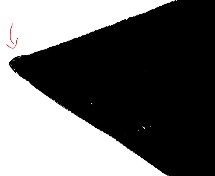

Hello everyone,
I attached some picture of what I want to do, I already put a threshold adjustment layer, now i want to select the biggest black object in the picture.
It is a one piece, and usually in different places so recording magic wand for example in the same location every time won't help, also Photoshop "Select Subject" isn't a good solution.
here are the pictures, let me know what you think
Dieses Thema wurde für Antworten geschlossen.
Beste Antwort von Kukurykus
I switched the two lines, value is 1, here is the immediate result:
edges are a bit not precise since it relies on work path:
So I used Select > Grow Like you told me on your first reply + Expand 4px,
It's not perfect because it's via paths but it's good enough, i will try on many more pictures and share them
Thank you
The value you switched to is too low as process will take too long time. Use at least value 2 or higher like I suggested so it's going to work very fast. I was aware of edges they will be rounded, and adviced to add part of code that fix that (however I guess you could do it manually).
You must specify the value of Magic Wand if you use 'Select / Grow'. I'm not sure why you then use Expand +4, but if you added additional step that selecting black pixels again you had perfect selection of your carpet. Anyway here is complete code for that:

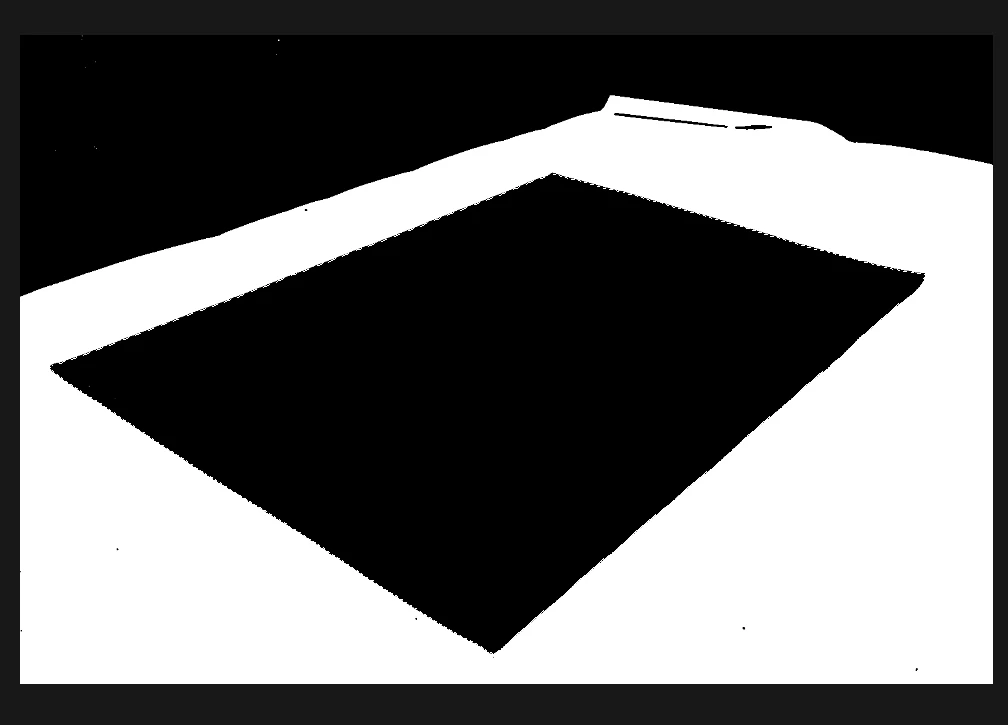

January 3, 2019
For your file.
Select white background with a magic wand.
Run the script.
You will get selected carpet.
select_max_selection();
alert("Done!");

February 8, 2019
"Select white background with a magic wand."
is there a way to automate it?
in the following picture I've added a relative 300px enlargement in canvas size, so the 300px "frame" is always white (maybe it can help),
maybe automate choosing top left pixel with magic wand? (resolution might change from picture to picture)
UP1: used Color Range, worked like a charm
