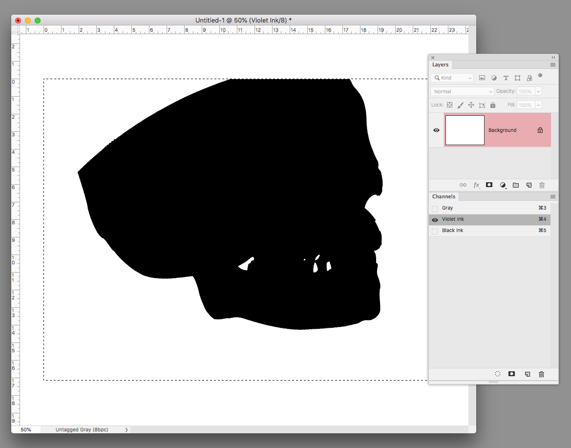

Usually with screen printing you want to use spot ink channels to make custom color separations. If you have art on layers the output will have to be to 4-color process CMYK using halftones.
So like this where the art is in Spot Channels, not Layers:
The output would be to Separations where you could print the two Spot Color Channels. I would place the two channel art into InDesign or Illustrator and print the separations
