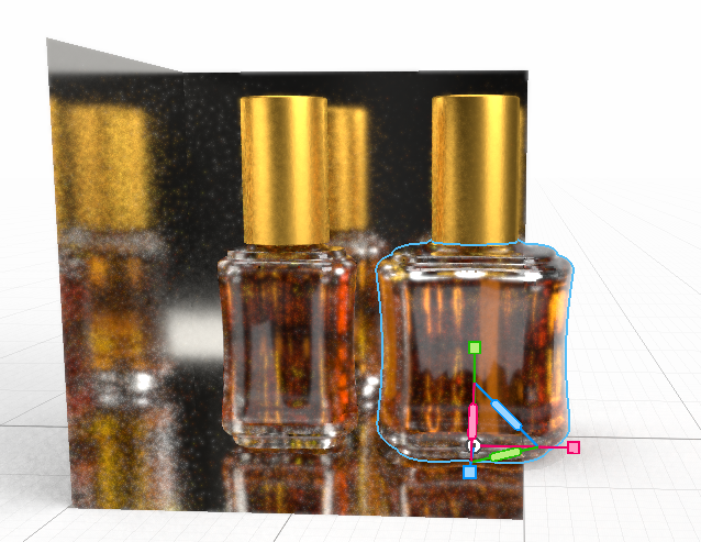

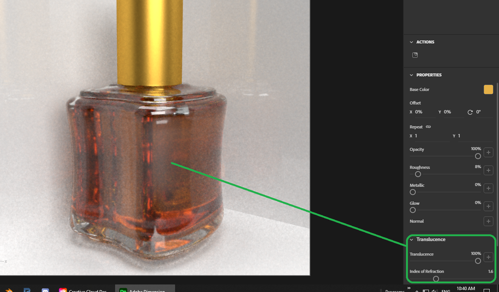

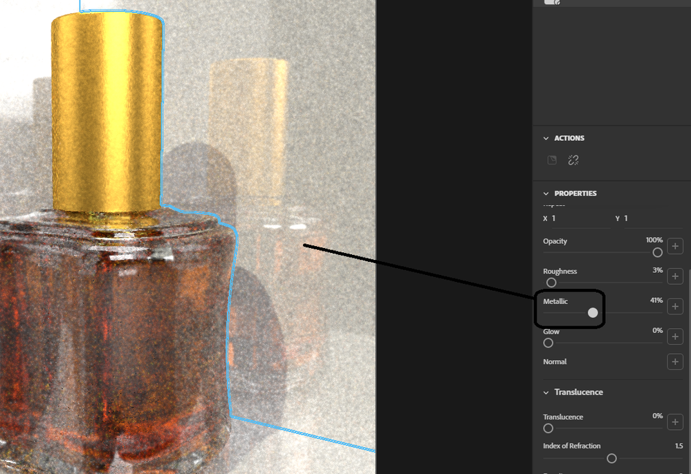

LEGEND ,
Jan 21, 2021 Jan 21, 2021
good question if you want reflection then maybe Dimension is what you need to make your Psd images?
  • Shadow = when a light hits an object and is blocked i.e, dirt simple and most any 3D software can make shadows
  • reflextion = when light hits and object and bounces back, the key here is the light itself is not as important as what material it hit... stone, paper, plastic, metal and the glass have zero to 100% reflextion \ metal
Photoshop is the only software I know that actually has both metal and reflextion because its older and in theory you could have a mat surface which reflexs but its more or less the same slider
distance and light do affect how shiny the surface is or if the reflextion is clear | out of focus but they don't make as much difference

  • Tranlucence = when light goes into an object and changes dirrection as different to opacity which is just show or hide without change of dirrection... this takes the most time to rendor and as a Mac users you should prob ignore it but Dave and I both have it in our images
