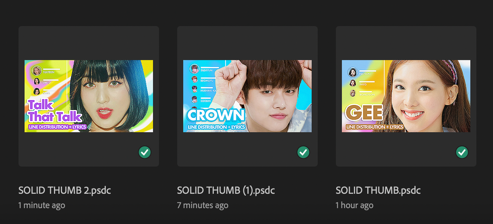

This is what the projects look like when I click the home button

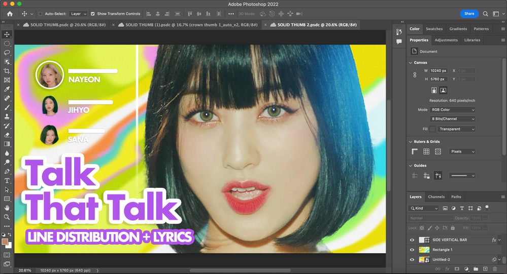

Screen Shot 2023-01-22 at 7.51.45 PM.pngScreen Shot 2023-01-22 at 7.51.57 PM.png
Yet this is what they look like when I actually open the project. Nothing happens when I sharpen them inside of the project but the sharpening shows when I click the home button to look at all my projects. Additionally, the sharpening doesn't show when I export the files.
