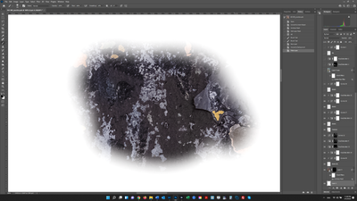

You can use the Mask of the Smart Filter or use multipple instances of the Smart Object, apply different Filters/Settings and Layer Masks to them.

Thank you.  Can you please share the steps of what you did in your screenshot?  I tried to figure it out, and turned my layer into a smart object.  Then I addded a mask.  Then I filled it with black, and painted with white to reveal pixels.  But this exposed pixels against a checkerboard.  So I saw that you had a white background layer and I added a Layer using Convert to Background.  This turned the checkerboard white.  What am I doing wrong?  Masks still trip me up a little (or a lot).  Thanks.
Jan 12, 2022 Jan 12, 2022
Duplicate the SO (cmd-J) before applying the Filter and Layer Mask.
This works out if the SO covers the whole Canvas anyway, if the SO itself contains transparency there are other options.
Advisor ,
Awesome.  This is exactly what I was looking for.  Thank you.

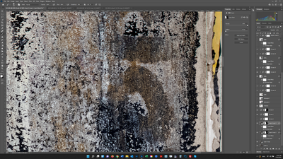

Follow up to the discussion from the other day:  I am trying to add another Smart Object Layer with Unmask-Sharpen Filter to refine my sharpening.  In the screenshot below, my Layer 0 Copy 2 has my initial, lesser shrpening for most of the left side and portion of the right middle side.  I copied the SO and bumped up the sharpen and started painting on the right side - but it's not showing up in the mask.  Any idea why?  Thank you.
Jan 16, 2022 Jan 16, 2022
The Layer Masks of the two SO instances look pretty much identical; maybe fill the Layer Mask of the top one with black and start painting again.

Thanks.  I'm not sure what I did here, but I tried again with a diffrent document; I created a duplicate SO and used a sharpen value of X; then I duped the bottom SO (without the filter/mask) and created another SO with a sharpen value of Y.  All worked well.  My assumption is that this is the right worklow - dupe subsequent SOs using other sharpen vlaues based on the bottom SO without the filter/mask; and it shouldn't matter the stacking order of the different SOs with different values.
Jan 19, 2022 Jan 19, 2022
The Layer Stack positions do matter, the top Layer would cover the lower ones.
