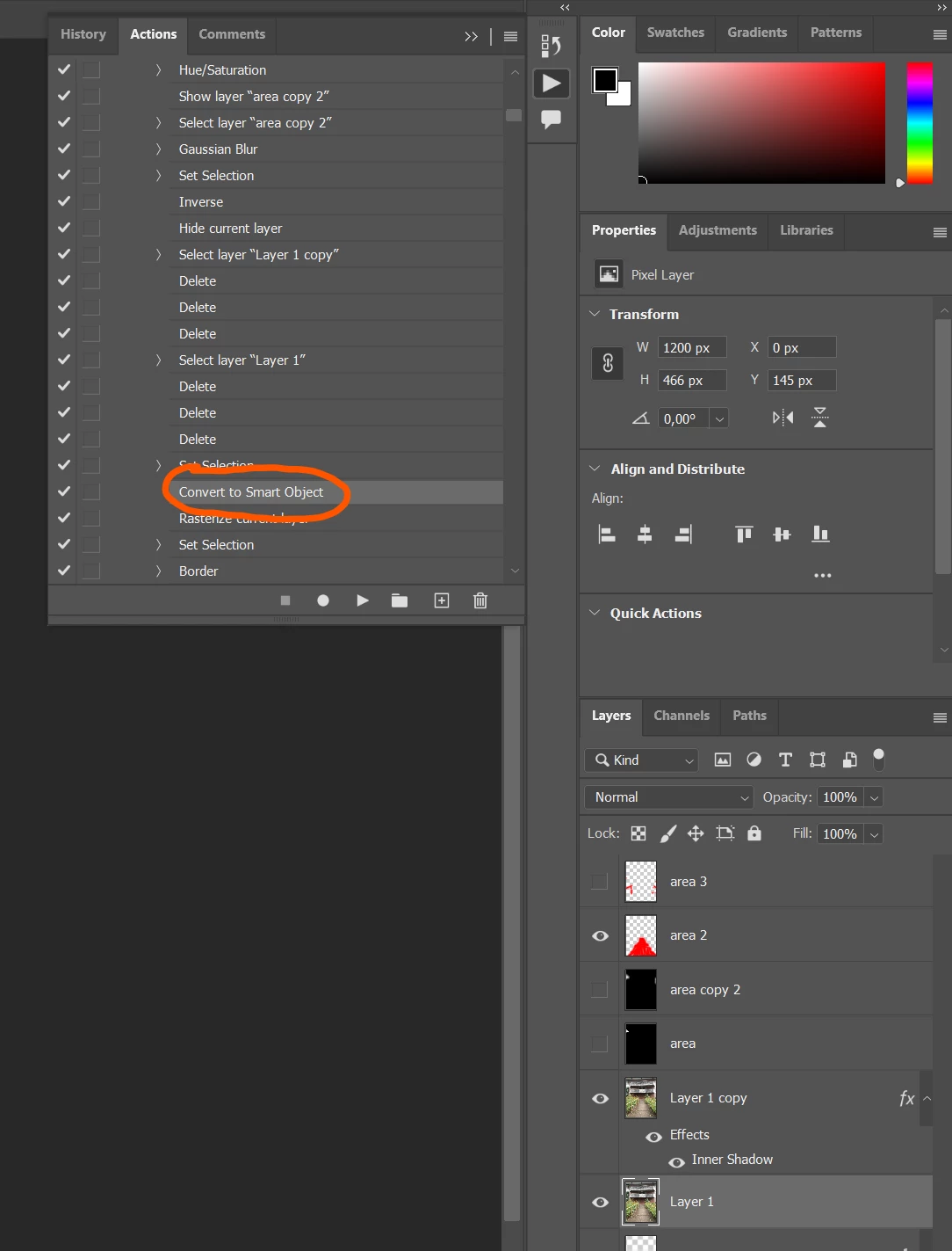

Hey guys! I'm trying to apply an action on a image in photoshop but in the middle of the process it select a layer and try to convert to smart object, however it simply doesn't do anything even if i try to do it manually, it's like the function was gone from software (with any layer i try, trust me) i tryed to uninstall and install it again and the problem still there. I don't know how to fix it!! please can someone help me? (i'm trying to apply a post apocalyptic action effect called "after human", just saying if there's a chance the problem be relatable)

I am just curious what is the purpose of Convert to Smart Object when the next step is Rasterize current layer? Perhaps the action is converting then rasterizing and effectivelly it does nothing? However, if you can not convert to SM using the manual method then there must be some problem on your system.

No reason to be confused. Bojan is spot on: the smart object is killed in the very next step! I have no idea what this action is for, but those two steps defeat their own purpose.

Ok, below the highlighted step in your screenshot is a  Rasterize current layer step. Click on the left side of Rasterize current layer to remove the checkmark so that action will not play that step. Another option is to drag Rasterize current layer to trash can to delete that step. Try disabling this step and if everything works as expected drag it onto the trash can.

i'm using the newest versgion of photoshop, CC 2023. i think i gonna do what you said, i tried to apply a different action from the same creator of this effect and it worked, so i'm very confused! if i try to convert to smart object OUT of that action it works fine.
