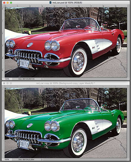

Lab Color Mode. a Channel curve. No brushwork.
If this begins on a duplicate layer, a simple mask will warm the specular whites.
(Note the flipped gray scales)

Lab Color Mode is different from RGB and CMYK. It consists of three channels: L (Lightness, controls tone), the a channel (which governs the magenta and green, and b channel (which governs yellow and blue), Lab has unique advantages, one of which is that it permits you to change a color separate from tonal scale. It is also an additional source for masks that allows you to minimize or completely eliminate brushwork. Although the L channel in Curves responds as you might expect, learning to control the  a and the  b  channels will be a new experience for you. If you are patient and have a desire to learn Lab Color, I could recommend a book to you.
In the example below, the a channel provided the basis for a mask. A simple curve change (in one channel) completed the job. No brushwork at all. Total time, about 3 minutes.
