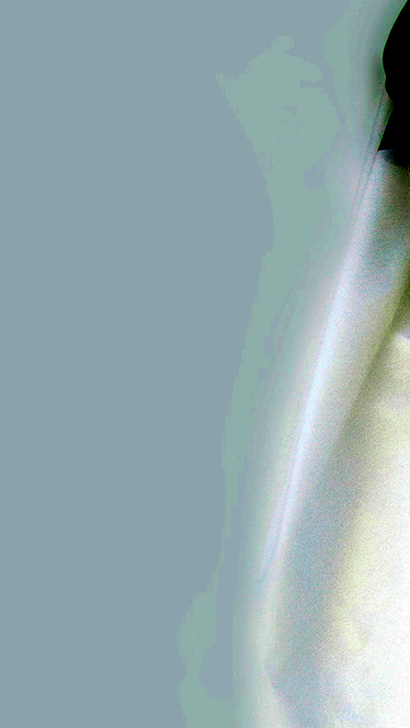

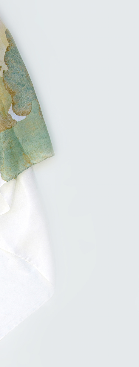

Screen Shot 2018-02-17 at 5.21.40 PM.pngScreen Shot 2018-02-17 at 5.21.36 PM.png
Have no before photos - it was just on a scratched up grey/white board. Can you see the strange marks I am talking about? They are green/white/grey. Even if I brush too 100% opacity over them, they remain when exported. It isn't only on this image too, it is other images that are similar

I pumped up the contrast to see better. Are these green areas what you're talking about? And they don't appear until after you export? what bit depth are you using to edit 8 or 16? what color spaces are you using?

Feb 16, 2018 Feb 16, 2018
Reducing down to 8 bit when you export could cause the posterization of subtle colors that you're seeing. Different spaces can further accentuate this issue by reducing the gamut of your colors: say going from a wider gamut color space of Adobe RGB to sRGB.
Feb 17, 2018 Feb 17, 2018
As Chuck explains, these marks are probably in your image before you export, but they aren’t noticeable because the 16bit size creates a much smoother transition between the subtle color changes. You could proof your image before exporting it using the technique Chuck used to check your exported image. Add a levels adjustment layer on top of the layer stack, and crank up the contrast. I’m guessing that you will see the marks. Let us know what you find. Maybe post another screen capture with the results.
