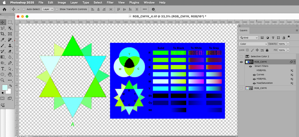

I have not come across any option in Photoshop that can separate colors strictly according to theoretical principles.
Here’s the basic theory that should ideally be followed:

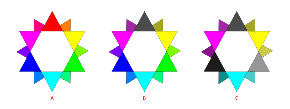

1. Tertiary colors: These are created by mixing primary and secondary colors, as shown in image (A). For example, orange is a mix of red and yellow. If red is completely removed, as in image (B), it should also be removed from orange, leaving only a shade of yellow.
2. Complete removal of primaries: If red, green, and blue are entirely removed from an image, as in image (C), the affected areas should appear gray. The luminance values should follow the correct order: blue (lowest), red, then green.
According to the standard grayscale conversion formula Y = 0.299R + 0.587G + 0.114B, the expected luminance values are:
 -Blue: 29
 -Red: 76
 -Green: 150RGB_CMYK.png
So far, I haven’t found any option in Photoshop that truly separates colors according to theory. Is there a recommended approach, workaround, or third-party solution that achieves this?

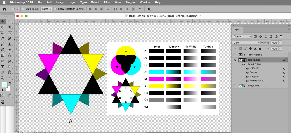

Sep 19, 2025 Sep 19, 2025
Probably not exactly what you need, but still.

Thank you for your reply. I have already tested a similar approach in Photoshop. The result looks close to what we want, but only because the example uses solid colors that are easy to identify. In practice, this method isn’t reliable—especially when applied to gradients, as shown in the example below—and it becomes even more challenging when the colors are less defined or difficult to identify.
I expected someone to point out an option in Photoshop for this, but am I asking for something that’s too difficult to achieve?RGBCMYK.jpg

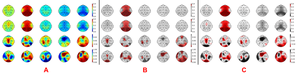

 3. It can be revolutionary in biomedical research.
The image below illustrates a brain mapping analysis. Image 'A' represents the original, while Image 'B' shows the same image with red color filtered using the traditional hue range method. Image 'C' depicts the same image, with red filtering applied using the theoretical color separation.
A comparison reveals that the traditional filtering method results in the loss of subtle red information, particularly lighter shades of red. In contrast, the theoretical color separation method preserves all red components, including those within the orange spectrum.
I have included the section on biomedical research, as several individuals expressed interest in understanding the relevance of Theoretical Color Separation.
                     Some technologies reveal their true potential only when we experiment with them.

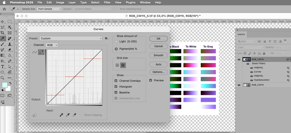

Sep 21, 2025 Sep 21, 2025
Thanks for the elaborate answer.
Alas, I am not sure there might not be misunderstandings on either side.
I suspect you might mix up concepts from different Color Models and you might be disregarding Color Management completely. (Though the latter might indeed be irrelevant in your use cases.)
(Edit: Or I might have misunderstood your explanations.)
As for medical imaging I am afraid your argument seems pointless to me.
As far as I know CT, MRI, PET, … produce one channel images to begin with and the images you are showning have already be processed/colorized, so the prudent approach to isolate regions of specific luminosities would probably be to start with the original grayscale images.
As for my last test one could change the Curves even more harshly – see screenshots; I have not drawn the red curve numerically exactly but if someone is willing to do the math and do it manually (or via a Script) it might be possible to get a more exact match.

1. I can understand your concern about the different color models and color management, as you are using HSB, HSL, and Hue/Saturation. However, for the simple task of separating colors, you’ve made things unnecessarily complicated. There is no need to use HSB, HSL, or Hue/Saturation.
2. Just to clarify, I was referring to biomedical research, not specifically to medical imaging.
The example image used in the biomedical research section is from QEEG (Quantitative Electroencephalography). To the best of my knowledge, in practice, most clinical and research QEEG reports use color-coded brain maps rather than grayscale images.
After reviewing several research papers on QEEG, one common observation is that colors like red and blue are often selected using a range in hue, as shown in the example below.
Moreover, similar use of color can be seen in pathology slides, where tissue samples are stained with color dyes. There are several such examples across biomedical research.
The key point is that whenever color is involved and traditional methods—such as hue-based selection—are used to separate colors, theoretical color separation can play an important role.
 Image Source
