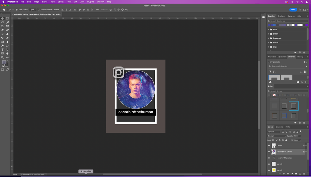

Thanks, it's completely random If you apply certain effects with a stoke this doesn't happen but with some it does.Screenshot 2022-12-01 at 15.49.25.png

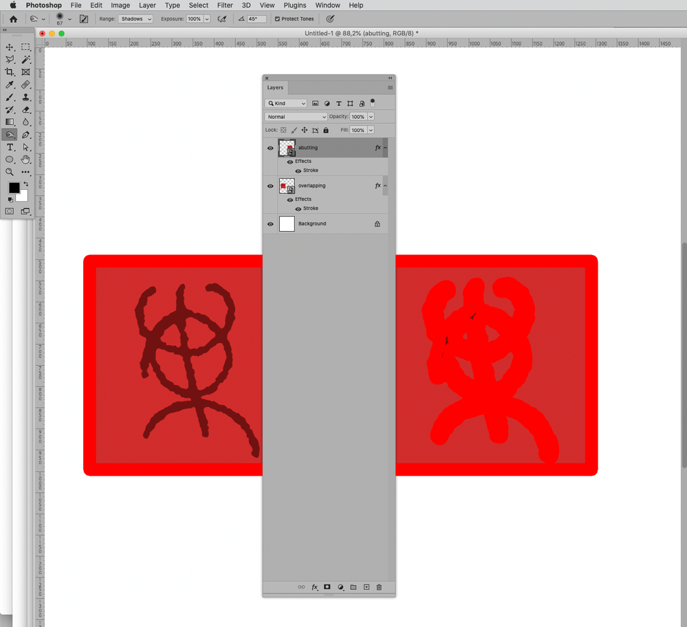

That seems wrong; with »Overlapping« I cannot reproduce your issue while it happens with »Abutting«.

Dec 03, 2022 Dec 03, 2022

It starts off as a squre. The bit I want is the circle in the middle. It gets rasterized then the edges of the square get chopped off. The stroke and inner shadow then goes round the circle. Hope that makes sense!
