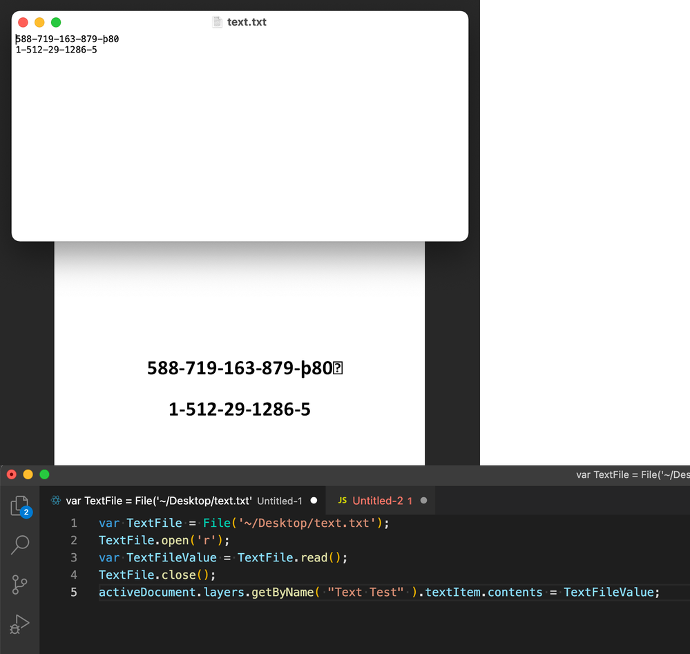

Perhaps you don't have .csv correct coding, like UTF-8?

I'm getting hyphens OK, however, I'm just getting a funky \r - \n linefeed character:
I haven't worked with a lot of text reads, so I'm sorry that I can't help any further.
Have you tried using code for the hyphens rather than the literal character?
Apr 23, 2022 Apr 23, 2022
Good point, I tested both UTF-8 and UTF-16 encoding and all three linefeed options.

There is ASCII as well and many other encodings which could be used.

I'm now using CSV UTF-8 (Comma delimited) (.csv) and it's working.
