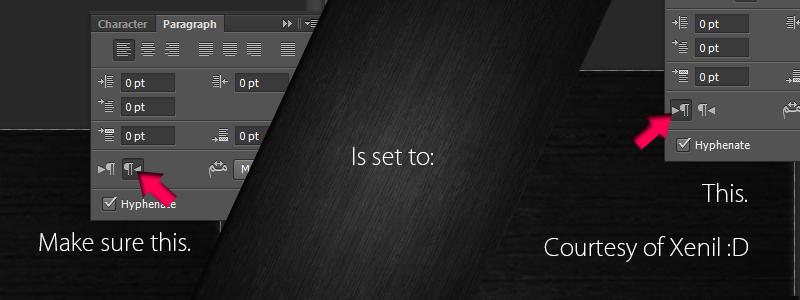

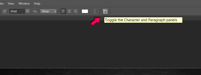

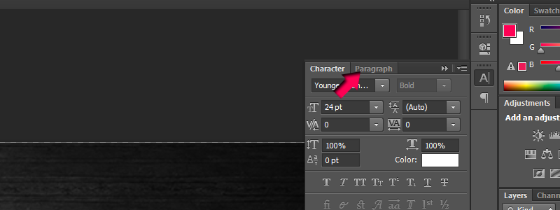

It did, thanks so much. In the link above scroll down to this post--it worked for me:
This is what you do:
NOTE: THIS DOES INCLUDE HAVING MIDDLE EASTERN SET, BUT ISN'T THE FIX ITSELF!
1. Go to 'Type' through the menu, or (preferences on mac) and make sure type set is set to Middle Eastern.
            There, wasn't so hard, was it? =]
2. Now, do this:
3.
4.
5. This may set back and forth if you have a certain text layer selected, so make sure you're doing this independently of any layers.
