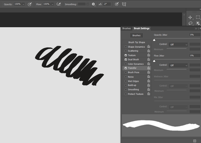

So I have this brush from an artist and I want to have the same effect which the artist can get a really nice dark stroke when he press the screen harder. But for my case, even if I press hard the stroke doesn't look dark enough. I used the same setting as the artist but it just doesnt work for me.
How to fix this?
The artist also have the pressure sensitive on, so turning this off will make it a solid dark and lose the brush effect.

Could you please post screenshots taken at View > 100% with the pertinent Panels (Toolbar, Layers, Brush Settings, Options Bar, …) visible for each relevant Brush Settings-element (Transfer and all other checked ones)?
Explorer ,
Jul 20, 2024 Jul 20, 2024
This are the screenshots of the brush setting. Please let me know if you need other info
I cannot make out the Brush Tip for the »Dual Brush« – what is it?
What happens if you turn off the »Dual Brush«?
It should not matter but why is this checked?

I did try to turn off the dual brush but nothing happened. The brush gives the same effect as before
What about the »Texture«?

You can see the brush preview of the exact same setting is different. I got like a solid flat brush.
This is really confusing

I looked at your »Transfer«-screenshot again:
Your Brush does not seem to work with Photoshop – note the exclamation point-icon.

I just noticed about this too. It says "control by pen pressure requires the use of a pressure sensitive tablet".
Is the something wrong with my wacom? I'm using wacom cintiq 16 @c.pfaffenbichler
