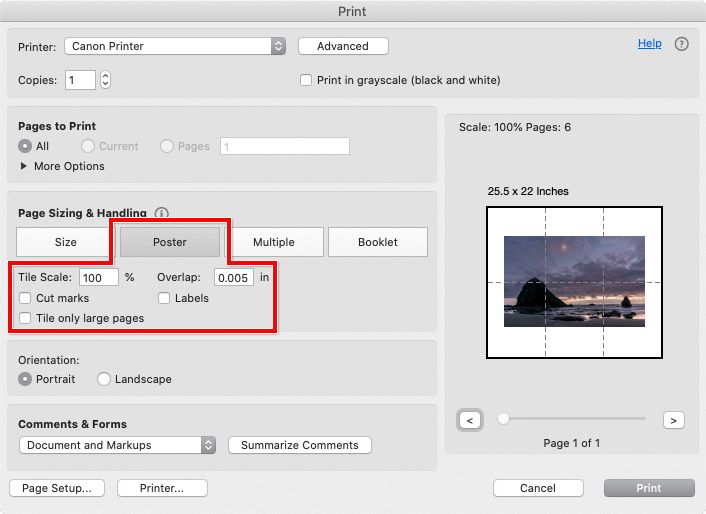

Acrobat is one option. And it’s fast and simple. All you have to do is drag the image and drop it on the Acrobat application icon, and it opens the image. Then you just choose File > Print, click the Poster button, and tiling options appear. You could be printing in seconds (if the correct printer and paper size are already selected).
Another option is Adobe InDesign. It takes a little more time because you have to create a document first. But after that, you simply drop the image on the page, choose File > Print, and click Setup to see the Tile options.
Either way it is really no big deal, and beacuse both have automatic tiling, both are a lot easier and faster than spending the time to set it up manually in Photoshop.

@EraSh I believe the free Acrobat Reader includes the tile feature
I hope this helps neil barstow, colourmanagement net - adobe forum volunteer - co-author: 'getting colour right' google me "neil barstow colourmanagement" for lots of free articles on colour management Help others by clicking "Correct Answer" if the question is answered. Found the answer elsewhere? Share it here. "Upvote" is for useful posts.

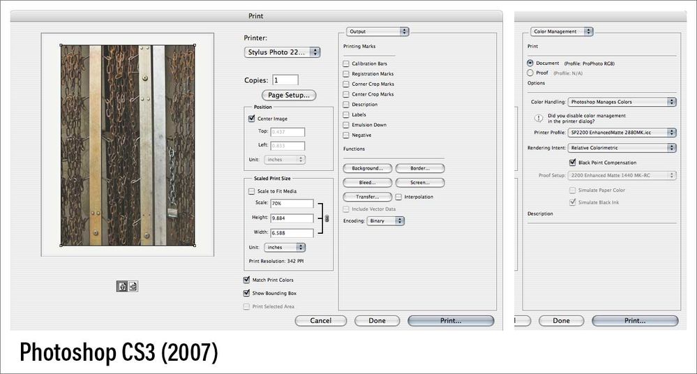

I do not think Photoshop has ever had tiled printing, and I’ve been using Photoshop since the early 1990s. I know people say it used to be there but I’ve never seen it. I even looked for and found some screen shots of older versions of Photoshop going back 30 years, and they do not show any print tiling feature, see the pictures below.
Can anyone show a screen shot of any version of Photoshop that shows tiling options in the Print dialog box?
I’m not opposed to print tiling, I think it would be good to have, I would probably use it at some point. But I don’t see any evidence that Photoshop ever had it before. I believe people are thinking of Illustrator, InDesign, or Acrobat; they’ve all had a print tiling feature for many years. (And it’s because those apps have print tiling that I agree Photoshop should offer it too.)

I agree, I have never seen tiling in Photoshop. However, I suspect that users may have seen tiling or similar  in a print driver, accessed via the Photoshop print dialogue's Print Settings button. For example Epson has a multi page poster printing option in the driver for my SCP5000.
Although that looks like a Photoshop option it is not, it is purely in the Epson print driver.
