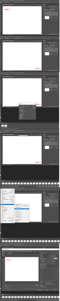

When I select both frames, the first frame becomes the same as the second frame. In the video, the two frames remain different. The teacher clicks back and forth on each frame and they're different. Why are my frames becoming the same? See attached screenshots.
I'm not able to move forward and tween without this step. I tried this so many times and a few times, it worked but then the animation was transparent throughout. Or it partially animated. It's very wonky and I can't remember what I did to make it work. But the majority of the times I've tried this, it did not work.

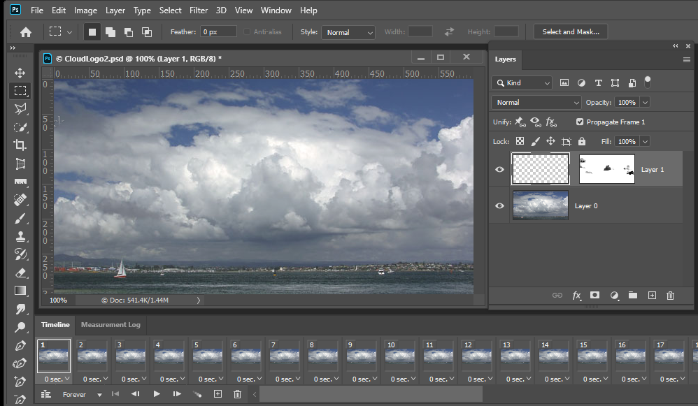

A Frame content is a composite of the layer visible in the layers palette for the frame and the layers position can be different in each frame. That is what tween is all about. Tween will create frame between two frames and move the layers that were moved between the two frames so the movement will be smooth rather than an abrupt move.
Here I created two layers and two frames and I moved the top layer's content off the canvas high and to the left in the first frame  and low and to the right in the second and last frame I created.  Tween generated the frames  between the two frames I created.

The layers are not different layers they are the same layers. However the content of layer 1 is positioned in different location in each frame. As you can see the frame animation PSD I posted only has  two layers the two layers are visible in all the animation frames. The bottom background layer 0 content position is not changed its location is the same in each frame.  Layer 1 is a is a normal raster layer that has a Layer mask that is not linked to the layer content. So the layer content can be moved independent from the layer mask which is what I did in the animation.  I created Frame one  with both layer visible and in that frame I moved the contents of layer 1 high and off canvas to the left. I then created the animation's last frame with both layers visible and in that frame I moved the contents of layer 1 off screen low and to the right.   I then used Tween to generate frame between the First and last frames.  Layer 0 and layer 1 are visible in all the nimation's frames.

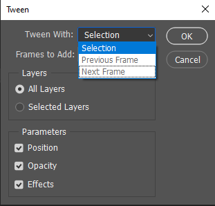

You tween between two frames.  The layer visible in those  two frames composite should be the sames layers and there should be differences in  layers positioning, opacity, effects between the two frames.   If there are no differences all frames add will be identical as the originals two frames.    When there are differences tween (between) the two frames will create transition frames with the approate options checje whict are bt default checked.
