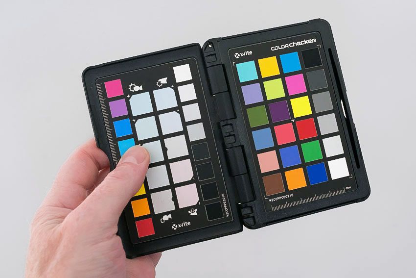

And then color. You really do need one of these. Put it in a reference shot:
You won't be able to match every color patch and that's not necessary; don't fuss over that. But use the neutral patches to set gray balance and overall tone. All the patches have standardized Lab values, translatable to any RGB. The third darkest gray should correspond to sRGB 124 (or 48% in Lightroom).

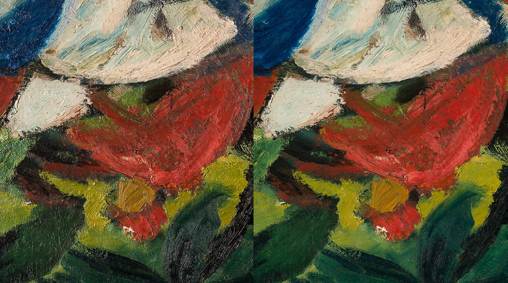

Reflections can be killed using cross-polarized light. That's a polarizer on the lens, and polarizing film on the light sources, rotated 90 degrees relative to each other. This removes pretty much all surface reflections (only workable with flash, or the polarizing film may melt). It will boost contrast and saturation a little more than what is strictly correct, so you'll need to dial down a bit in post. Here's an example:
