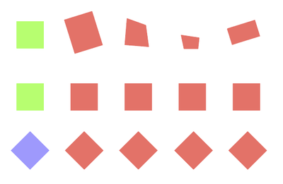

Maybe I'm dreaming but is there a tool which can take one image as a reference (example in image: green and purple square) and then resize, rotate, stretch others items (red ones) to have the exact same shape as the refernce? I made this in Illustrator just to show what I mean, but I am looking for something like this for isolated images in PS.

Jul 06, 2021 Jul 06, 2021
You can\s do a constrained resize to change a image sized so the image will not distort  its  aspect ratio and shape will not change.  If you change an image aspect ratio during a resize the resulting image will be distorted and have a different shape and aspect ratio.  Images can be rotated, rotation changes the image aspect ratio and shape however, the image's content remain the same there is no scaling or distortion.  Any time you resample a raster image to resize it including rotation you loose some image quality during the interpolation process.
You can write a Script that willautomare the resizing of an  image to fill some shape area. Position the image to that area and mask the images to shape.  I would not know how one could also automate additional roration  and distortion like perspective.  For it is easty to create s shaped selection to bet filled with an image by a script. However the script would some  strong  AI code to know the shape means  image needs some image perspective distortion or rotation or every evert image aspect need to change scale, distortion and rotation is required.
You can create mockup templates that have Smart objects layers that will  have their content replaced  by scriprs with other images. The smart object layers can include  Object transforming that includes rotation and distortion.
Thank you JJMack, I understand the capabilities and effects of the transformation tools be it vetor or pixel images. But what I'm thinking of is a bulk transformation based on the reference shape.
This is usefull for example if you want 100s of product shots (which theoretically have the same shape) to be exactly the same shape. Because even with good photos as a staritng point there is always slight misalignment.
