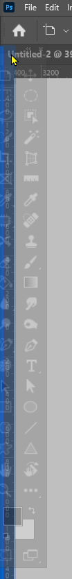

March 2, 2023
Thanks! The toolbar is docked, but you did give me an idea: Undocking the toolbar and moving it about 10px from the edge seems to solve the issue, kind of annoying that I can't dock it though. When I do dock it I get an "overflow" of blue onto the second monitor:

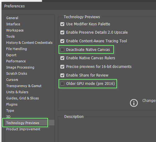

What version of Photoshop are you using? Try experimenting with these settings.
The bottom line is, and I am not 100% on this, if the toolbar is docked, I don't think it can overflow into the left hand screen.
