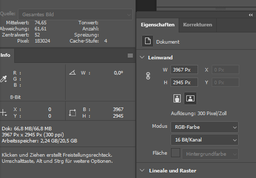

Explorer ,
Oct 14, 2024 Oct 14, 2024
Yes, that's what I thought at first, that I would find the answer to my question in the histogram,
but unfortunately it works less for me than in your example.
I have just opened an image with the data width 3967 px x height 2945 px for testing.
According to my calculation, that's 11682815, but Photoshop shows 183024!
What should I make of this?
What is the file format?
Is the file flattened or layered?
Explorer ,

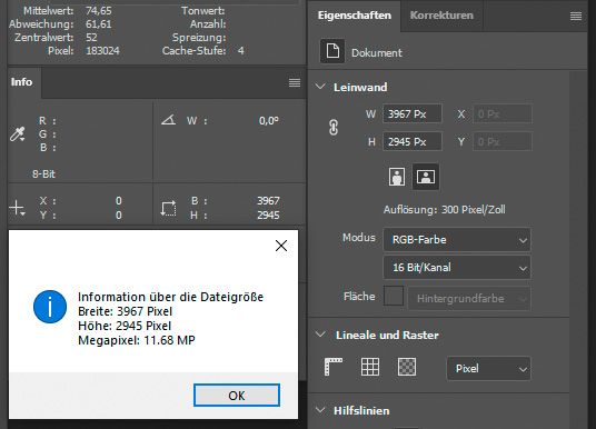

Explorer ,
Oct 16, 2024 Oct 16, 2024
With the help of Rick Maschke, the problem is solved.
https://www.youtube.com/watch?v=eGE0kJhE-0s
