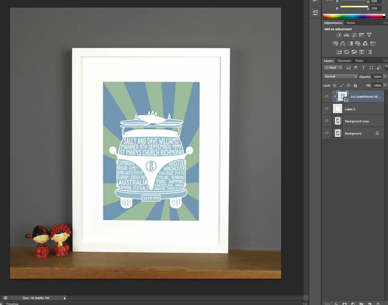

Hi there. I have managed to create my own 'mock up' template which has a picture frame on it that I can use to put in my own image. I just did this by selecting the inner image area, creating a clipping mask and then converting to smart object. However what I ideally would like is to create a template that I could use to automate for batch processing. ie. I have over 100 images that I would like to insert into the picture frame and then save these as individual files, named individually as per the inserted image. Here is an example of my picture frame file:

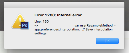

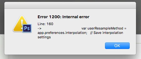

I have also tried to use .JJMack's PhotoCollageToolkit which looks as if may solve the problem but I am getting various error messages. When I try to use the Collage Template Builder I get this error message:

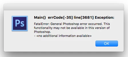

and when I just take the plunge and test the template with the TestCollageTemplate script I get this error message:
I am using PS CS6 only version 13.0 x64. I appreciate that it must have taken hours and hours to create something like this ToolKit and I am sure many many people have benefited from it.

Something similar can be done for your template as in this thread How to fit image in particular frame? The difference between box and picture frame does not change anything. Exactly the same approach can work for your mockup. The only difference is that you will need to use (probably) Reveal All command in action after copying and pasting composition in the file which is open and used to substitute image in Smart Object layer (image open by Image Processor Pro in batch).
If you have any further question do not hesitate to ask. I gave you my opinion and insight without to actually test and check anything and pulling things from my memory but I am pretty sure that action provided for Claudio can work for you. It will need your time and effort to watch video and understand how to prepare template (one that you have posted above, I guess).
October 9, 2018
Hi Bojan. Apologies I had not noticed the video that you had posted. I was just looking at the top answer on the thread. I scrawled down to find your video and watched that. I have uploaded your Action, downloaded Image Processor Pro and ..... success! It has all worked. There was white space on the bottom of my jpegs but I reread your instructions and ticked the trim box in replace SO content action and bingo it worked! Thanks SO much you have saved me. Apologies for not having realised that the answer was staring me in the face!
