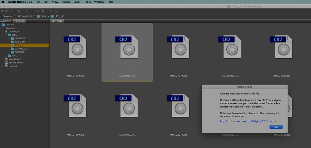

Hi all,
As per the title, I am not able to open the CR2 files in CS6 camera raw. Camera files are from Canon 5D iii. I have MBPro 2013.
5D iii is supported by Camera Raw 9.1.1, which reads up to date in About Camera Raw
I know I can DNG convert these files, but its a extra workaround that takes time.
All CS6 apps are up to date via Help-Updates...
Does anyone knows how to fix this issue?

Does menu Help>About Plug-in>Camera Raw... show 9.1.1.461 swan?
JJMack

What's the error message?
Jan 31, 2020 Jan 31, 2020
What does happen when you try to open one of your D5 mk III RAW CR2 files in Photoshop? You never stated what happens you just stated you can not open them? I use windows and just download a sample 5d III sample CR2 file and had no Problem wit it opening in ACR 91.1.

Applogies for not putting the error message already. I get the pop up dialog which shows this:

Perhaps you're opening ACR hosted by Bridge, not Photoshop. Or the other way round. IIRC there were two separate copies of the plugin installed in CS6, one in Photoshop and one in Bridge (now they run off the same copy).
So maybe one of them is missing. It's possible to open both from Bridge, but the procedures are a little different.

Try opening from Photoshop. On Windows ACR 9.1.1 is installed into a shared plug-in folder that is shared between Photoshop and Bridge. It is not installed in the normal Photoshop Plug-in folder.   If it were to be installed into the normals Photoshop plug-in folder ACR 9.1.1 would open in Photoshop but not in Bridge. ACR 6 may open in bridge instead.  Make sure that there is only one ACR 91.1 plug-in on you machine and the it is installed into the correct folder the no other ACR plug-in is also installed..  Windows still has 32 bit  support so I have two ACR versions 64bit version and 64 bit version I also have CS3, and CC installed besides CS6. So I have 5  Camera Raw.8bi files CS3 is 32bit only.

Your Bridge version only supports ACR version 8.7.1. That is the last version of ACR that works with Bridge CS6.
PS CS6 will support ACR 9.1.1 but in Bridge you have to Double Click on the image file to Send it to PS. It will then open in ACR first. You can't Right Click on it in Bridge and select Open in Camera RAW.
Basically Bridge is trying to use ACR 9.1.1 and it can't. You even might have to use the File Open in PS to get it to open in ACR 9.1.1. Not sure as I never used CS6 of PS. Went from CS5 to the CC subscription
https://helpx.adobe.com/camera-raw/kb/camera-raw-compatible-applications.html#main_Note_6

No, Bridge cs6 on both mac and windows supports the same 9.1.1 camera raw that photoshop cs6 does, in fact they use the same camera raw plugin located in a common plugin folder as pointed out by JJMack.
Unfortunately, adobe has a bad habit of not updating their KB documents, so what adobe says about bridge cs6 is incorrect.

Ok I have uploaded here CS6 camera raw where I have opened an jpeg image in it, if you look at the top interface of the open dialog, its showing Camera Raw 7.0. How can that be, that means im on the very old version of it?
I have just installed (found it online) CameraRaw_9_12 and CameraRaw_10_5. The problem is still the same.
Just to be clear, I have disc of full CS6 suite I bought from Adobe years ago. I have had made an install and then went to CS6 Photoshop Help-Updates.. and made full update via that route.
Also, I have installed Ps2020 as well, could that be hampering the CS6 plug in?

As stated in one of my previous replies CS6 can't use any version of ACR above 9.1.
So even if those other 2 versions of ACR installed into the correct folder to be seen by PS/CS6 PS/CS6 will NOT use them.
As mentioned above I have searched for ACR 9.1 and just for the hexk of it ACR 8.7.1 and neither are available from Adobe. Personally I think that is wrong and the one notice I did find was to try updating ACR from Inside PS (and I guess inside bridge).
So how long has PS CS6 been installed on your system? And have you been able to Update PS/CS6 from inside PS? There certainly was not just one release of PS/CS6. There had to be several Point releases over the couple of years it was available

I have it installed only for about 3 weeks now. And I did made an full update from Inside PS, went to Help - Upates... which opened Application Manager and there I went away with it.
I wasnt able to find ACR 9.1 anywhere as well, only older versions.
