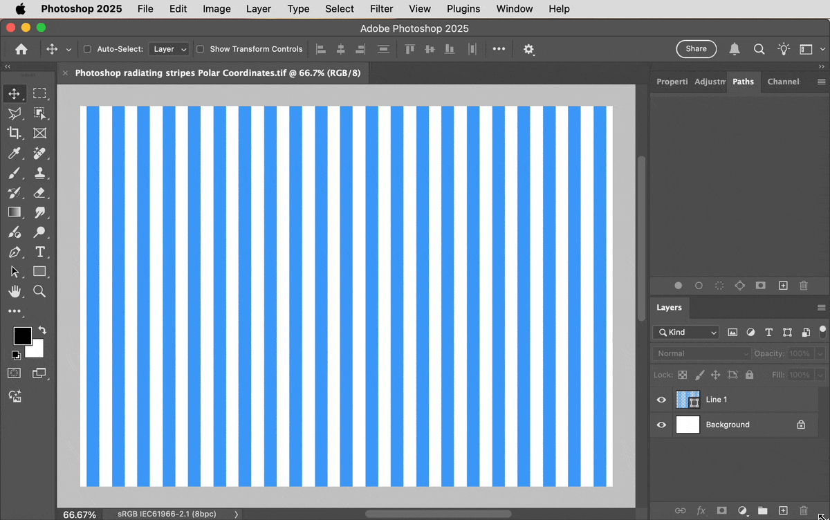

Hi Dave, sorry off subject here but you seem very knowledgable! do you happen to know how to create the lines all going into the distance on this image?
I’m not Dave, but it occurred to me that if you start with a bunch of stripes, the Polar Coordinates filter can take you the rest of the way, as shown in the demo below.
