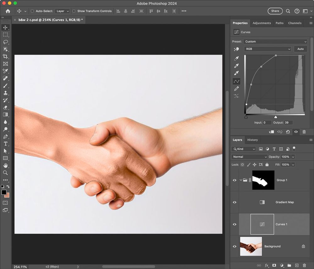

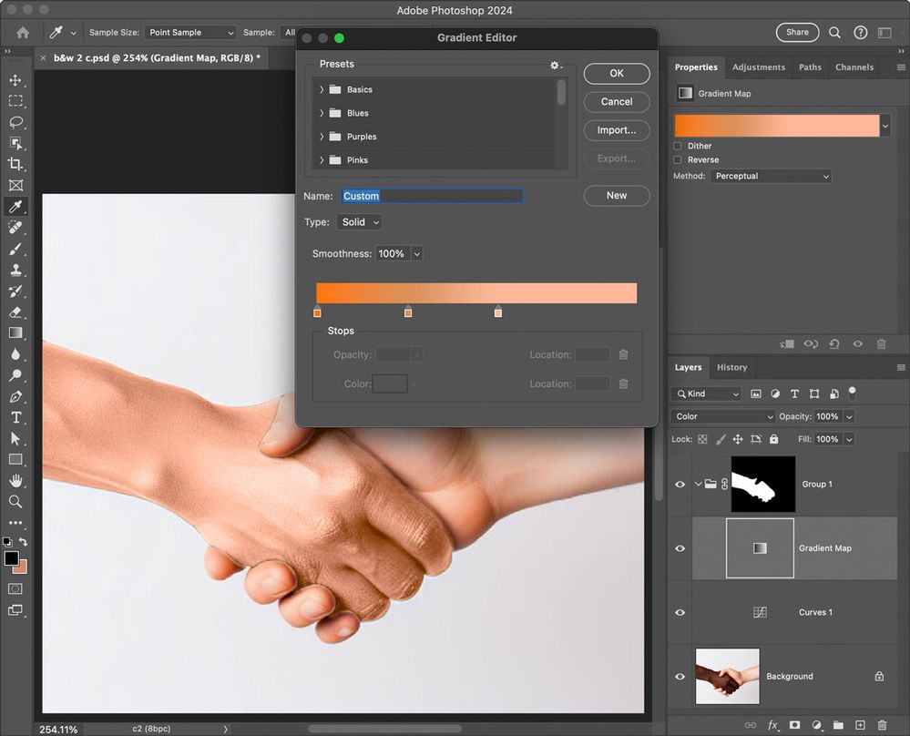

No color name is needed. I looked at the layers in your file, and you may want to try a different approach. I started over with your base layer, and got the results below. I based this on a simple color-changing technique that you can learn in the Photoshop Training Channel tutorial video at the end of this post. That technique uses just two layers: A Solid Color Fill layer set to Color blending mode, and a Levels adjustment layer used only to remap the tones. Both are masked to the dark hand through a layer group mask. I tried to achieve more control by replacing the Solid Color fill layer with a Gradient Map layer, and by replacing Levels with Curves. I wanted to see if adding color stops to the Gradient Map would provide more color variation from light to shadow.
For this example it wasn’t necessary to know what the color value numbers should be…I simply sampled the color from the light skin, and that set the initial target values.
In my version, the mask edge where the two hands meet does not look good because I didn’t spend much time on that part. You might also want to retouch the areas on the light hand that were near the original dark hand, because the now lighter skin should reflect more light on the hand on the right.
