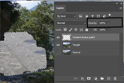

Alternatively, you may try this workflow as well. For easier understanding, referring to the A – target image and B – source image.
  • Put target layer A on top in the Layers pane and make the selection of where you want to apply the content aware fill.
  • Reduce Target layer’s opacity from the layer panel to 0% as shown below which will reveal source layer –B.
  • Now go to Edit > Content Aware Fill.
  • The preview window should appear to be empty. When you select Sample All Layers, you will have the source image visible in the preview window. (Might have to play with the parameters as per your expected output)
  • Highlight the sampling areas & when we have taken the sample from the source press OK. Ensure Output to > New Layer is selected for harmonization filter later.
  • The output should have an Opacity of 0%, please increase it along with the target layer.
We have created a patch you may adjust it further to better suit your composition. This workflow might be a longer route to something simple.
As additional tip, for more sampling input for Photoshop, you can keep multiple layers with equal levels of opacity and then use sample all layers.

We understand. There are more than a few ways to achieve what you are looking for in this case. Reducing opacity to 0% is just for example. Please feel free to try with different levels of transparencies with different layers as well.
Also, if other images have the subjects which you would like to carry over to your target image, try other pixel manipulation tools like Content Aware Patch, Content Aware Move and other retouching tools (Spot Healing Brush).
