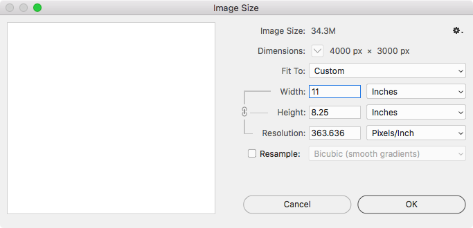

You can change the output dimensions, but keep the original 4000 x 3000 pixel dimensions by unchecking Resample in the Image Size dialog and setting the desired output Width and Height:
This does not add or remove any pixels, the output pixel size is scaled with the Width and Height dimensions. Note that the Width, Height, and Resolution are constrained.

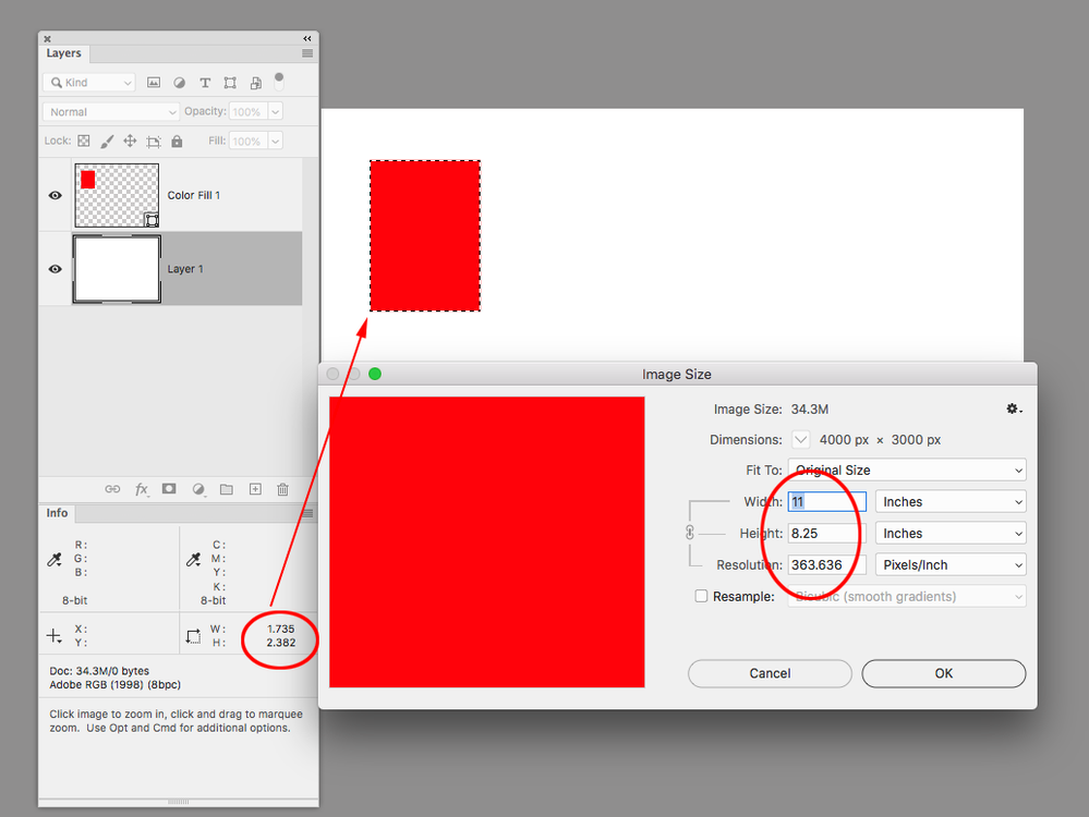

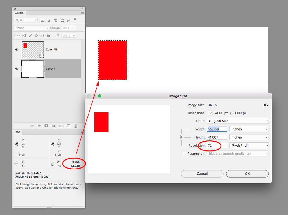

Just to clarify, in my post I have Resample unchecked, so there is no sampling—the image output dimensions and resolution are simply scaled together and the pixel dimensions are unchanged.
With Resample unchecked a vector or text layer’s output dimensions will get scaled along with the canvas:

Mar 01, 2020 Mar 01, 2020
Yes with Resampling not checked the only sizing done is  Pixels are sized according to the documents Print resolution. The Document Composite Pixel image is printed with pixels that size.    Pixels are rendered for vector layers using vector graphics functions then these pixels are blend into the Document composite image using the layer's blending  features like blending mode, opacity, fill and blend if options.   The Document composite image's  blended pixels are print with pixels sized by the document's print resolution.   Changing the Document Print resolution changes the Images Pixel size.  Prints will have the same pixels printed a different size.  The print will be different in size. All the sized print will have exactly the same pixels but be different in size because of their pixels size.
