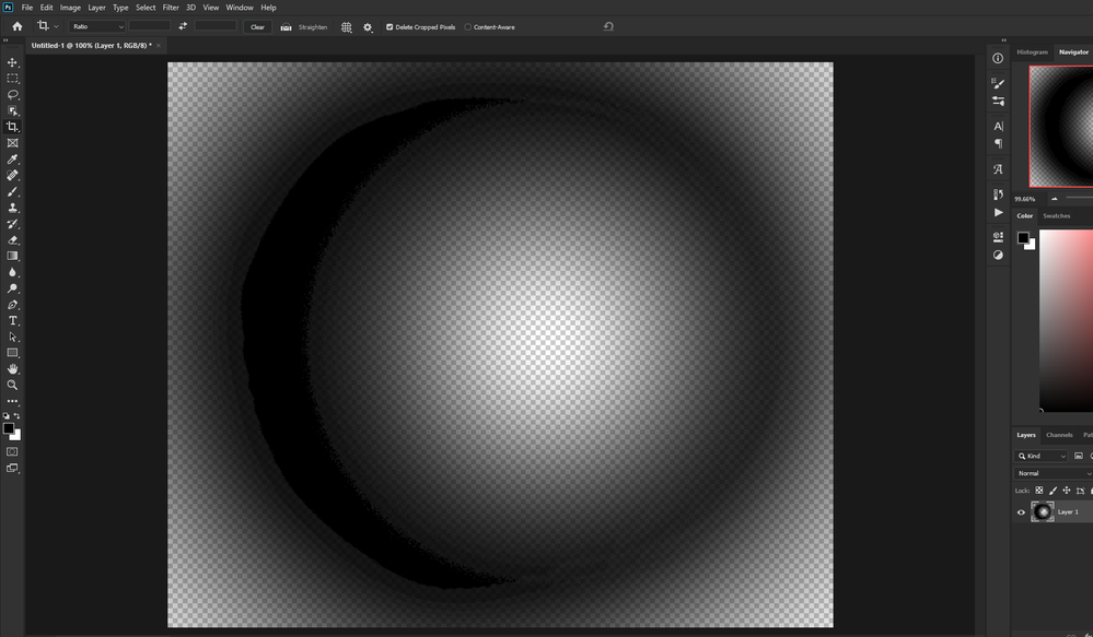

This just started happening an hour ago and I'm pretty sure I must have done something to cause it, but for the life of me can't figure out how I did it. Can't seem to find a problem like this online either, all of them are usually solved by switching to the correct brush / changing blending mode.
Here's the gist: when drawing with a soft brush, or erasing with a soft eraser over a transparent background, the color appears to be distorted and edges pixelated. It looks just fine over a background, though.
Screenshot of the effect:
Video can be seen here.

It is just a preview rendering artifact, and has been that way for years. It does not affect your actual image.
Put a temporary solid layer at the bottom of the layer stack then remove it, or turn off visibility, before exporting/saving.

Here's another example where dithering and hard edges are clearly visible.
The image below was drawn with soft brushes and is almost entirely black:
However, this is what it looks like in Photoshop:
Mentor ,
Feb 24, 2022 Feb 24, 2022
that's just the weird rendering that happens over the transparent grid pattern. You can disable the grid in Prefs.

This has to do with blend gamma - the transparency "curve" from fully opaque to fully transparent.
There is a checkbox in Color Settings to "blend RGB using gamma x.x", and if you check this (default value 1.0), you get the same appearance whther transparent or white background. Unfortunately, you then get the "bad" appearance in both cases.
Photoshop uses a custom blend gamma value that will most closely correspond to how ink behaves on paper. I think it's somewhere around 1.5.
I don't know enough about the technical background here, but apparently blend gamma only applies when there is actually something to blend with - either a background color or an underlying layer.
In other words, I don't think there's an easy way around this.
