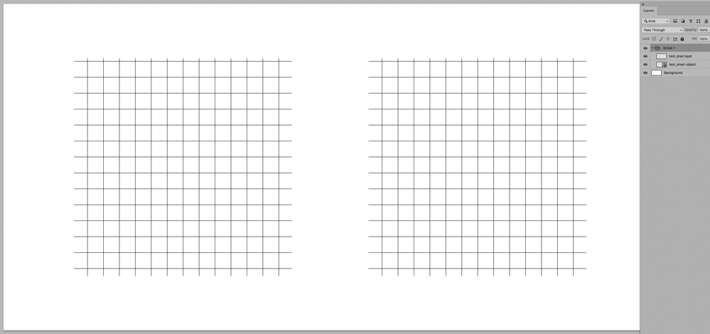

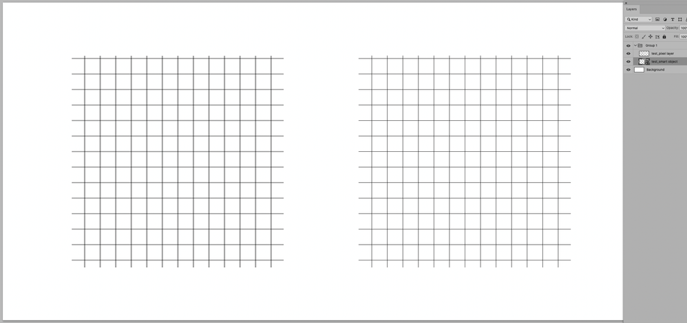

A simple example:
A pixel Layer and a Smart Object, scaled down to 50%, then scaled up to 200% (so basically a round-trip to the original size) with Bicubic Automatic.
smartObjectVersusDestructiveEditingScr1.pngsmartObjectVersusDestructiveEditingScr2.pngsmartObjectVersusDestructiveEditingScr3.png
