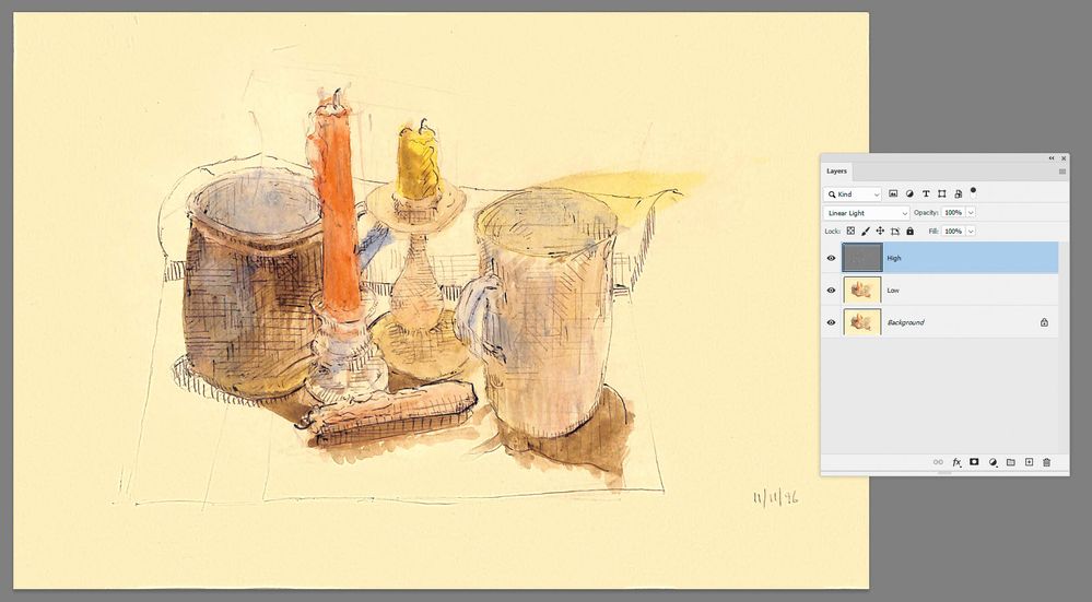

You might want to consider using Frequency Separation to separate the low frequency colours and the high frequency detail onto separate layers. This would allow you to treat each separately.
The detailed steps are set out below and, of course, they can be built into actions:
1. Make 2 duplicates of your image layer
Name the lower - "Low frequency"
Name the Higher - "High Frequency"
2. Select the Low frequency layer and use Filter Gaussian Blur (around 6.0)
3. Select the High frequency layer
Go to menu Image > Apply Image
Set the source layer to Low Frequency
Set the blending mode to Subtract
Set Scale to 2 *
Set offset to 128 *
Click OK
4. Change the blending mode of the high frequency layer to Linear Light
5. Now you can clone out blemishes on the high frequency layer and lighten or darken areas and smooth out variations on the low frequency layer. Don't forget though to set tools such as colour sampler, or spot healing, to sample 'current layer'.
* Note - the above steps are for 8 bit/channel images. For 16 bit/channel step 3 changes slightly
Check "Invert" next to channel
Set the blending mode to Add
Set Scale to 2
Set Offset to 0
Click OK
Now carry on with step 4 above
Dave

Thanks for this Dave. I tried your technique with an 8 bit image. Unfortunately the Gaussian blur wasn't enough to blend all the colors in one of my images. I will try it again but I will probably use Conrads suggestion of using the variance slider, point Color, camera raw filter which seems to have a very good effect. Thank you for this contribution however. Bri
