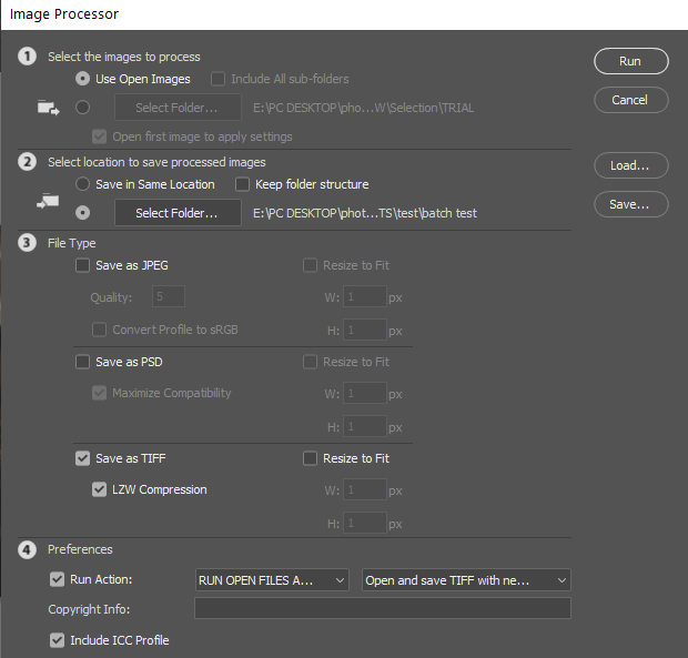

<-- Okay, thanks for clearing that up! I now see this issue, and I need to run the action by going to FILE-->SCRIPT-->IMAGE PROCESSOR instaed of  file-automate-batch.
The solution partially works.
The TIFF files are saving, and the correct file is now opening but there are just a few issues:
  1. The file is immediately opening as a copy, and not running on the original RAW file. PS-image processor-opens copy.PNG
  2. I needed to add an action to close the RAW file, because the following message was popping up and the RAW file was not closing.
Adding an extra step to close previous document works, but then the new TIFF is not being automatically recognized in Lightroom... Is it because tiff is being saved in the TIFF folder that is created when PS runs the image processor?
Can you advise if maybe there is something I need to click on/off in the IMAGE PROCESSOR perameters so that LR will recognize the TIFF file? Below is what I have selected:
