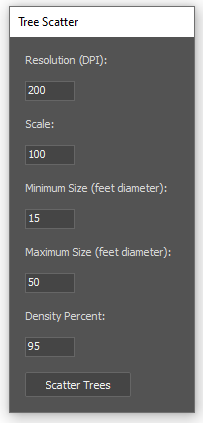

    // Create a dialog for setting parameters
    var dlg = new Window("dialog", "Tree Scatter");
    dlg.orientation = "column";
    dlg.alignChildren = "left";
    dlg.add("statictext", undefined, "Resolution (DPI):");
    var resolutionInput = dlg.add("edittext", undefined, "200");
    resolutionInput.characters = 5;
    dlg.add("statictext", undefined, "Scale:");
    var scaleInput = dlg.add("edittext", undefined, "100");
    scaleInput.characters = 5;
    dlg.add("statictext", undefined, "Minimum Size (feet diameter):");
    var minSizeInput = dlg.add("edittext", undefined, "15");
    minSizeInput.characters = 5;
    dlg.add("statictext", undefined, "Maximum Size (feet diameter):");
    var maxSizeInput = dlg.add("edittext", undefined, "50");
    maxSizeInput.characters = 5;
    dlg.add("statictext", undefined, "Density Percent:");
    var densityInput = dlg.add("edittext", undefined, "95");
    densityInput.characters = 5;
    var scatterButton = dlg.add("button", undefined, "Scatter Trees");
    scatterButton.onClick = function() {
        var resolution = parseFloat(resolutionInput.text);
        var scale = parseFloat(scaleInput.text);
        var minSizeFeet = parseFloat(minSizeInput.text);
        var maxSizeFeet = parseFloat(maxSizeInput.text);
        var treeDensity = parseFloat(densityInput.text);
        if (isNaN(resolution) || isNaN(scale) || isNaN(minSizeFeet) || isNaN(maxSizeFeet) || isNaN(treeDensity)) {
            alert("Please enter valid numerical values for all fields.");
            return;
        if (resolution <= 0 || scale <= 0 || minSizeFeet <= 0 || maxSizeFeet <= 0 || treeDensity <= 0 || treeDensity > 100) {
            alert("Resolution, scale, sizes, and density must be positive numbers; density must be 0-100.");
            return;
        if (minSizeFeet > maxSizeFeet) {
            alert("Minimum size cannot be greater than maximum size.");
            return;
        scatterPNGsInArea(pngPaths, scale, treeDensity, resolution, minSizeFeet, maxSizeFeet);
        dlg.close();
    dlg.show();
main();
