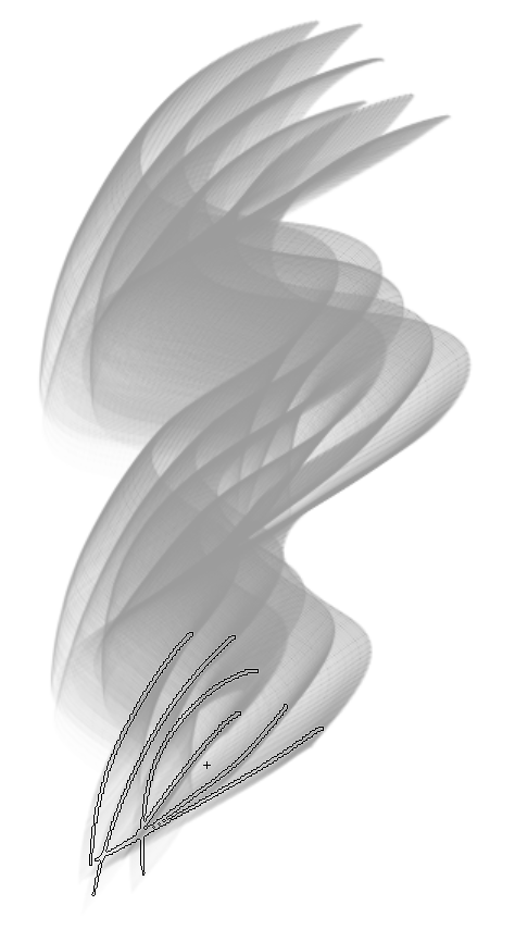

One last thought, but again it is only a guess until we see the single stamp of the brush, is if the preset you sampled has converging lines like below — which is similar to your screen shot but without the shadow — then we can predict that this will definitely produce a background shadow because the lines will smear.
This is the above with no settings applied, and with a 1% spacing
