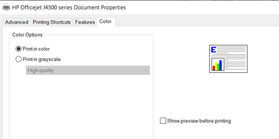

Here's are some other suggestions for trouble-shooting the problem.  Go to Windows>Settings>Devices>Printers & Scanners.  Select the USB printer and go into the printer settings/printer defaults.  I suspect that your default Color mode is set to  black/greyscale rather than color.  Here is my Epson printer driver dialog but the HP should have something similar:
Actually, here is what I have for an old HP print driver on my machine:
Perhaps better yet would be to Delete the current printer from the Device settings and reinstall the printer.  Reinstalling the software may not have fixed the issue because the old preferences would probably have been retained.
Also, I don't think you have told us whether you have tried printing from the Organizer.  If you get the same problem there, then that would confirm that the default settings for the printer are to print in black/white or greyscale.
Added:  I also note that the screenshot in your original post is for a black and white photo.  So if you are frequently switching between color and b/w printing, something may easily have gone wrong with the default settings.
