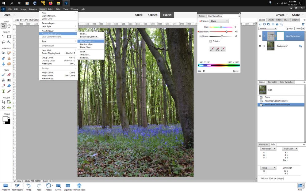

You can use an Hue/saturation Adjustment Layer (Layer>New adjustment Layer>Hue/Saturation) select Blues from the Channel menu and then adjust the Saturation slider for the desired effect.
