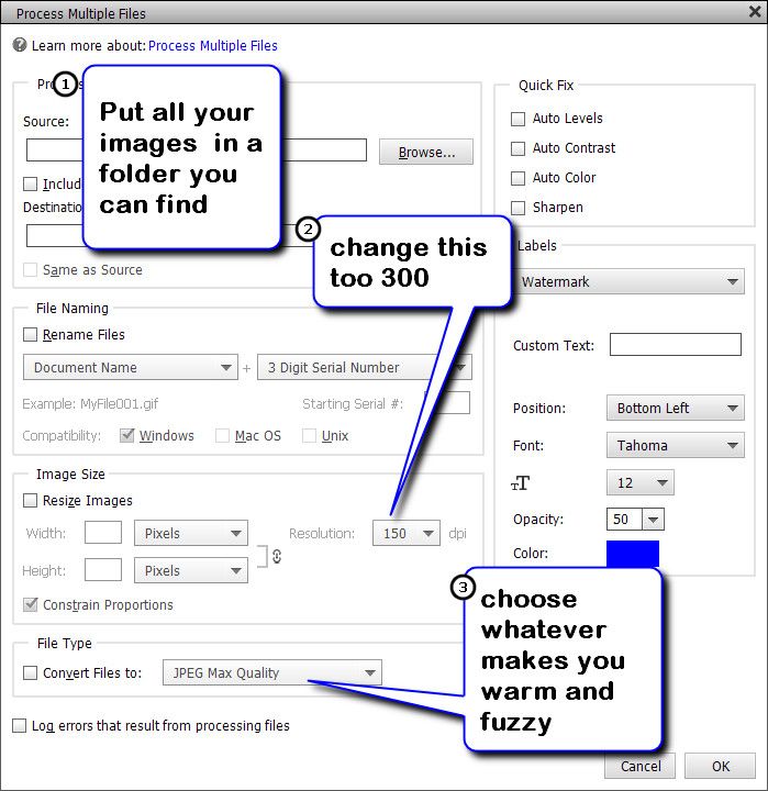

Batch process them first to change the PPI to 300.
FILE / BATCH PROCESS:  2021-10-16_181624.jpg

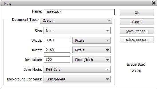

MAKE A CUSTOM CANVAS THIS SIZE AND SAVE IT.
People talk about 4k and don't have a clue what it means.

Thanks. Very helpful. Is the batch processing software a free utility I can download?
Community Beginner ,
Oct 16, 2021 Oct 16, 2021
Found it!
