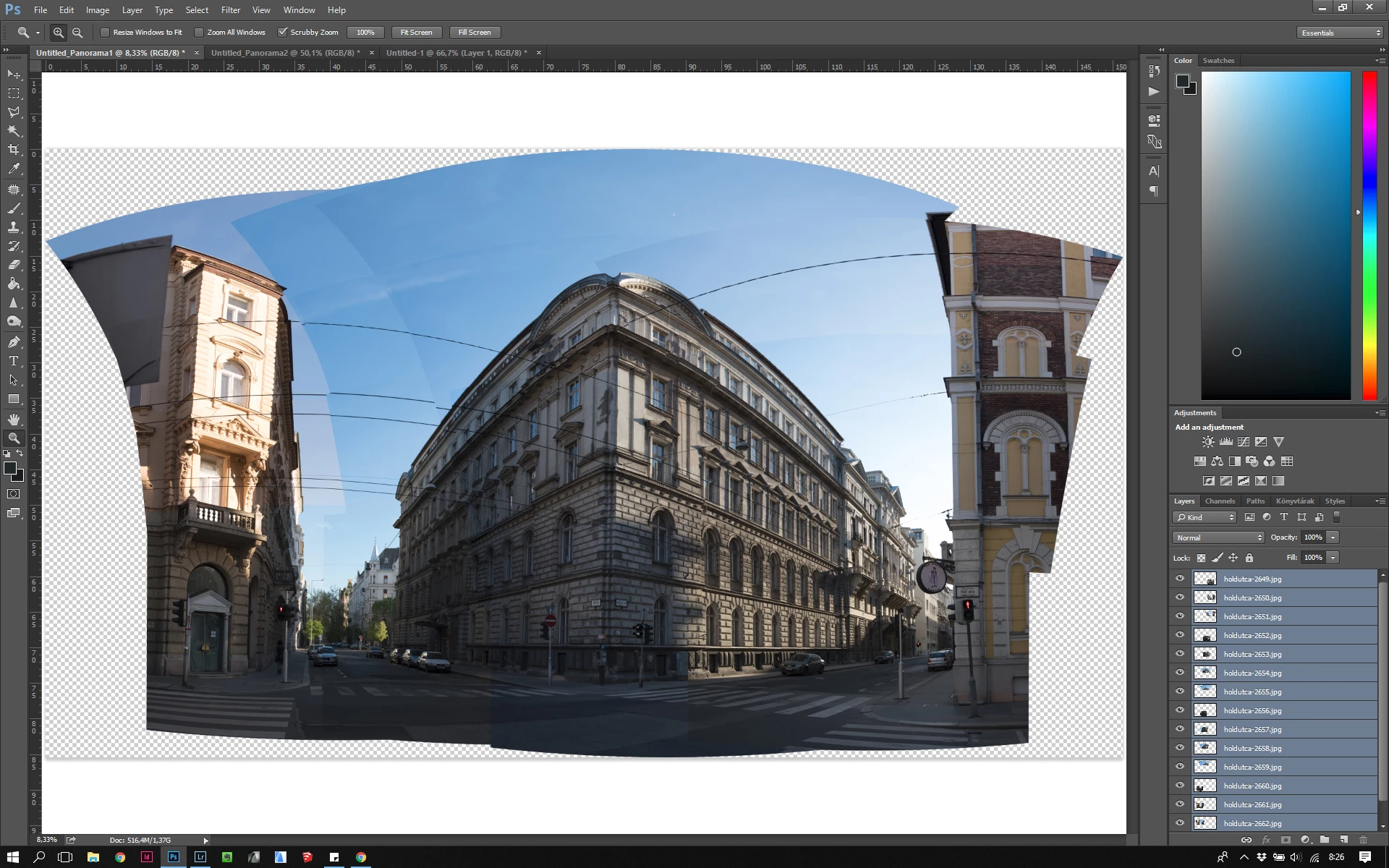

If i'm using the original photo resolution (24mp), it doesn't do it properly, see photo:
First of all, it doesn't use any masking layers. You could see the edges of the separate photos, so the tones doesn't match, nor the lines in some areas. (I used manual mode, the exposure, iso, focal length, etc was the same for all photos)

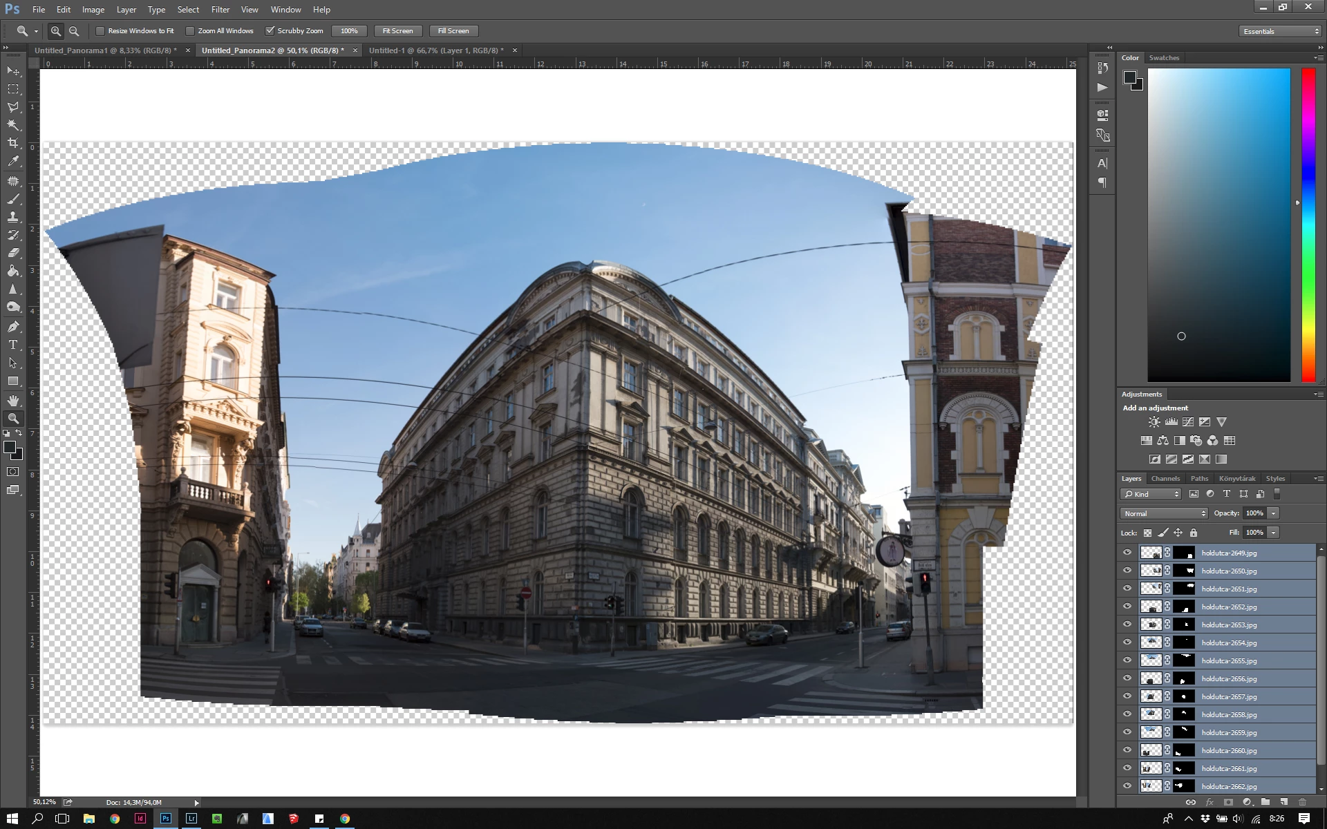

Then I did the same Photomerge with the same photos, but I downsized them to 1000px wide in Lightroom. Now the results were good:

Correct answer norbertj15305618
norbertj15305618  wrote
I have about 10 gbs free space on my SSD HDD.
That's nowhere near enough! The scratch file for something like this will easily exceed that. Free space for the scratch disk should at least be in the 100 to 150GB range.
I think Dag was involved with the discussion
No, that wasn't me - but I always, routinely, pick a center frame and put that at the bottom of the stack. Lock it or turn it into a Background layer. All the other frames will align to this.
And as always, take great care to minimize or eliminate parallax error. The slightest misalignment between shots can throw the whole thing off.
Oh, one more thing - you have a lot more control if you split the Photomerge script into its constituent parts: Auto-align > Auto-blend. With Photomerge you're in the passenger seat.
Hey,
it seems the lack of free space was the problem. Now I had around 20 gbs, and it did the trick.
Thanks for the extra info though!
N.
