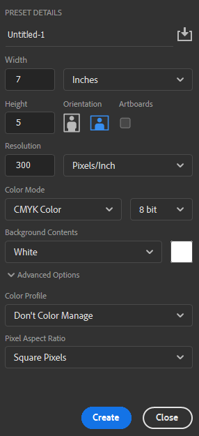

So using this would be wrong in Photoshop if I am working on things that would be printed?
Mar 01, 2020 Mar 01, 2020
»I definitely know that I should work in CMYK for prints...«
What kind of images or designs are you talking about?
If you are talking about photoshgraphic images you may have misunderstood the issue.
If you are talking about designs or Illustrations with black linework or text or areas of primary and/or secondary colors working in CMYK may make sense indeed but then the question would arise if working in Photoshop is prudent in this case.
