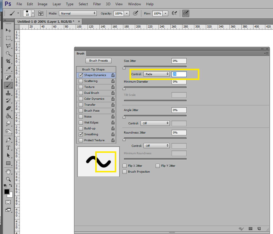

I'd like for the brush to go from thick to thin - to taper. When I go into the brush Window and set it to Fade, nothing happens:
I don't understand why it's not showing me a tapered shape. When I do the same thing for my Eraser tool, it works:
So what I am doing wrong with when using the Brush tool?

Hi michaelm52071012
One thing I see is that Trevor has settings of 800 and 500 for the Fade and yours is 25. What happens when you increase it?
