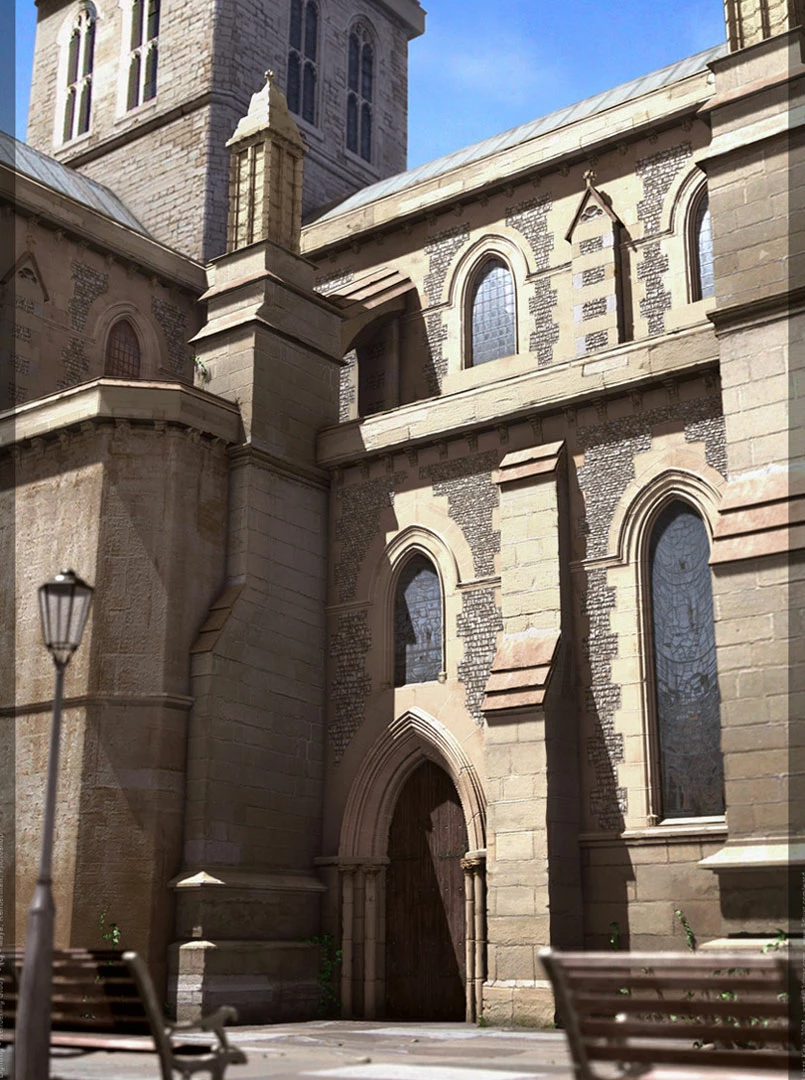

I need to create a stain glass window texture map but as seen from the outside of a cathedral.   I have attached two images to illustrate what I wish to do.
The first image of the church shows the windows as seen from the outside.  You can see the outline of the lead strips holding the glass fragments together.    The second image is what I need to "reverse".
I'm not sure of the best method to create this effect so I would appreciate any help from somebody who is familiar with a technique that will work.
Thank you.

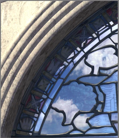

    Once done you can make a material for the lead and one for the glass. I assume you are using this texture for 3D - if so then you can set the reflections to balance the reflection of the sky but just see a hint of colour in the glass.
    I used these steps to quickly make a corner of the window in Photoshop 3D below. I did not have time to trace the whole window but hopefully you get the idea. The stonework is a 3D extrusion from a paving slab.
