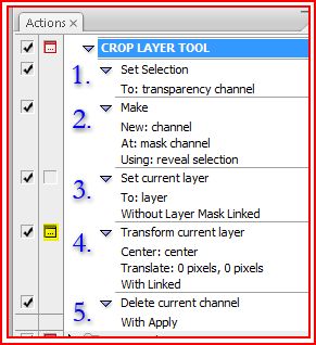

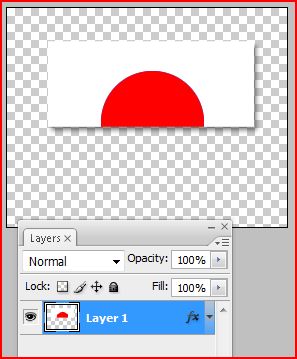

    In the meantime, you can make your own Crop Layer Tool. It uses a simple action. A layer mask is created, adjusted, and applied. When invoked, the action adds the mask, unlinks the mask,  and chooses the Transform Tool. Then it pauses for you to make your crop. The first thing you see looks pretty much like Crop Tool. Except that the boundary of the layer is selected instead of the canvas. Note that the layer mask is selected.
    Drag it just like the Crop Tool. You are transforming the mask, which crops the layer. And you see a live preview, effects and all.
    When satisfied, hit Enter to accept the crop. The action then applies the mask. The result is below. The layer has been cropped.

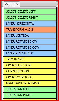

    With Actions in Button Mode and a keyboard shortcut assigned, the Tool/Action is accessed with as much ease and used the same as the Image Crop Tool.
    Below is the action.
    How to make the action.
    Start recording.
    1. Ctrl+Click on the layer thumbnail.
    2. Click on the Add Layer Mask button at the bottom of the layers palette.
    3. Click on the link between mask and layer thumbs to release the link.
    4. Select the Transfrom Tool (Ctrl+T). The layer mask should still be selected. Drag boundary to a new position. Doesn't matter where. It will need to be reset after the action is recorded. Hit enter.
    5. Right Click on layer mask thumbnail and select Apply Layer Mask.
    Stop recording.
    Now go back to step 4, Transform. Set it to conditional (highlighted above). This will make it stop so you can make your crop. Next, double click on the command. This will select the Transform Tool. In the options bar set the scale percentages highlighted below to 100%,
    This is necessary because Actions won't record a null transformation. But once recorded, you can reset to the original state. And if the mask isn't at 100% we won't see the whole layer when the action stops for the crop.
    This may sound like a lot, but it shouldn't take more than 5 minutes to set up the action following the above instructions. And for that small investment, you have a Layer Crop Tool which works just like any other tool. You select it with the mouse or keyboard shortcut, make your adjustment, then hit enter.
