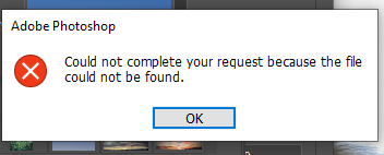

This afternoon I was fiddling with the new sky replacement features, using the default skies. For whatever reason, I got a crash and now every time I come to use the feature I get "Could not complete your request because the file could not be found" every time I select a default sky. I've identified the folder I believe the files should be in, but they're not there. Is there any way that I can reinstall the files? I've already done a reinstall but kept my preferences - will I need to do a completely fresh install to get them back?
I'm able to add my own files and it works fine, but i'd like the default ones back!
Is the error I get. Thanks!

Thank you for your feedback. First of all, could you please provide some more details on how the crash happened, e.g. did it happen when you were selecting a sky preset, or when you were adjusting a slider on the sky replacement dialog? We'd really appreciate if you could let us know more about it so we could fix the crash as soon as possible.
Regarding the error you get after the crash, I think it is likely that your default sky presets files got damaged due to the crash. Here is a way to recover all the default sky presets for you:
Open Sky Replacement, open the sky presets view, click the small icon on the top right corner, and select "Append Default Skies...". All the default sky presets should be appended at the end of your presets list. You can now delete all the old default sky presets folders in the list.

same problem, did what you daid, but it still gives the same message

Sorry for the inconvenience again. Please try the following to restore your default sky presets:
1) Open Sky Replacement, multi-select all the presets and folders, and then delete them. You should see an empty view on the preset panel now. Then close Sky Replacment by clicking "OK".
2) Reopen Sky Replacement. You should see all the default sky presets shown again.
3) If this still does not work, you might have to reset your preferences, and relaunch Photoshop. Then reopen Sky Replacement. You should see all the default sky presets shown again.
Please let us know if this works for you. Meanwhile, we are working on the fix for this issue, and it should be available very soon.
